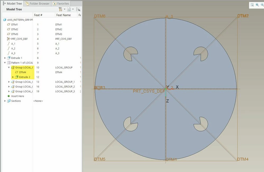

The trick here is to use a datum plane to control the clocking angle of the extrude. You can then group the datum and extrusion and use axis pattern. I have enclosed a sample model (Creo 4) that has the orientation of all extrusions pointing at the central axis using an axial pattern.
Query the sketch of the pattern leader (Extrude 2) and you will see that datum 4 is used as a sketch orientation reference which will control direction of your extrude.
Use of clocking reference to orient extrusion in patternUse of clocking reference to orient extrusion in pattern

tbraxton, thank you for your answer and files! Your way works great with symmetric shapes but when you try to make it for my shape you'll see result shown on my post's second image and I'd like to get result shown on the first image. Besides, (I'm sorry I forgot mention it in origin post), the distance between the shapes horizontally and vertically is different... So we cannot use the axial pattern.
The thing is I don't need to use a pattern to do it - I'd just like to make it as good as possible. I'm searching for the best way and healthy practice so that the model tree and design intent will be clear.
Do you have some idea?
