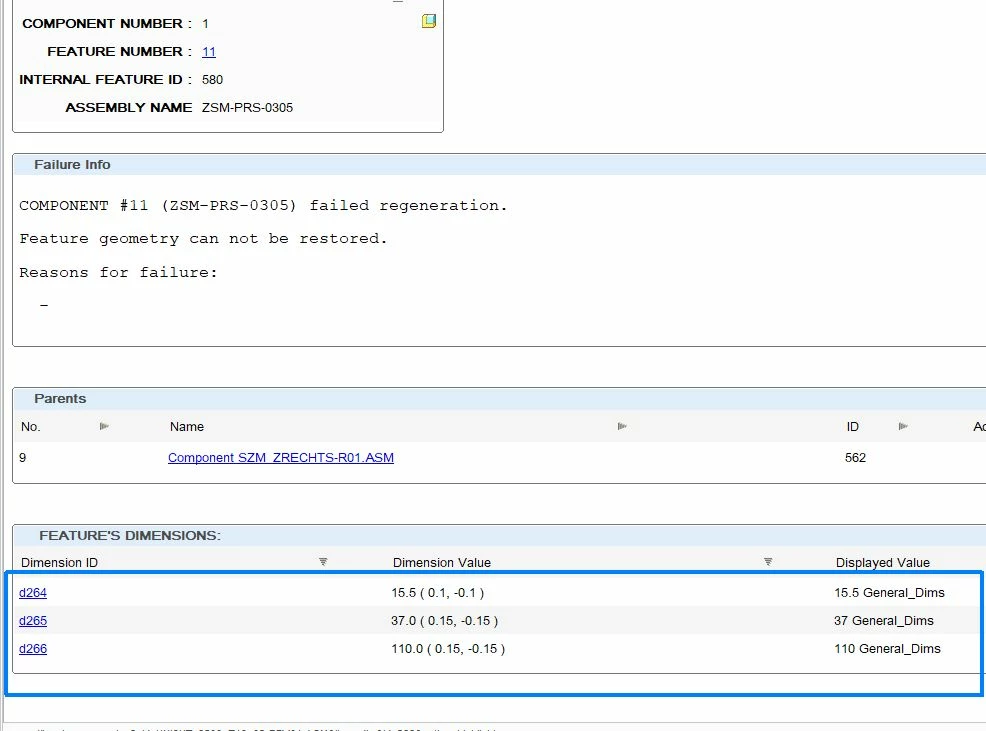

Good morning,
I've been working for a few months on a prototype.
All things worked well until three weeks ago.

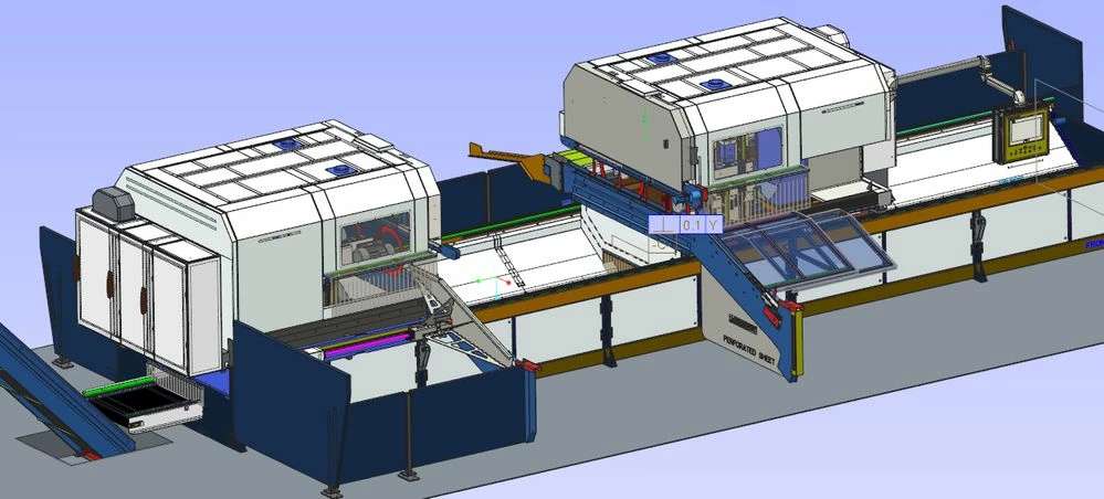

This prototype has a few subassembly of the first level, every subasembly has a few subassembly of the second level an so on.

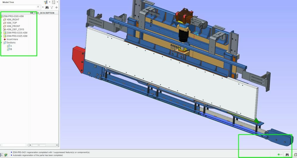

On this topic I attach the example with my problem.

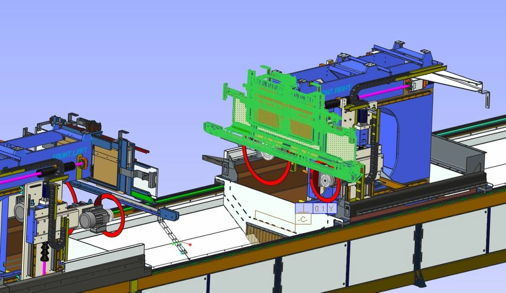

In the underlined subassembly I can not change it constrained placement.
It behaves as if it were frozen , freeze , lock......

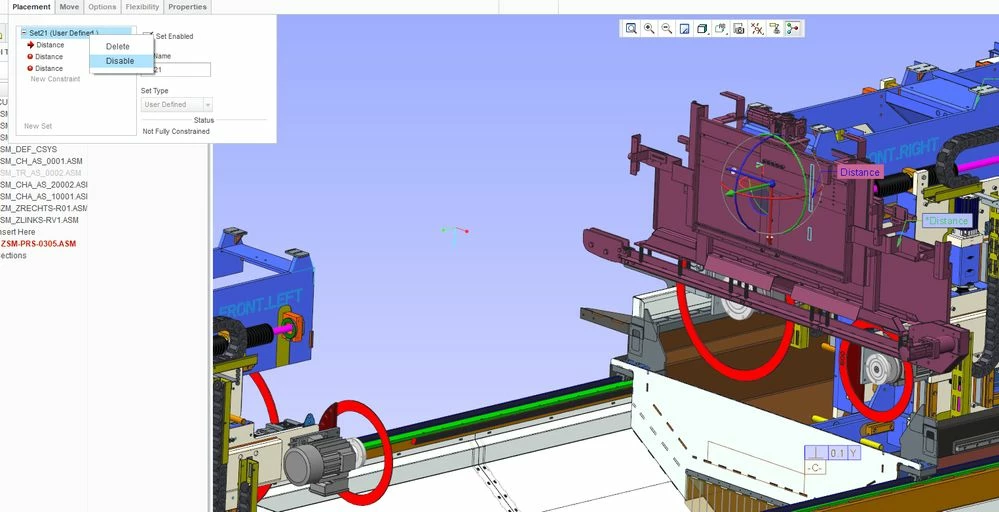

I try :
- edit value constrained placement (fix, default....);
- delete all constrained placement;
- suppres constrained placement;
- delete subassembly from main assembly;
- suppres subassembly from main assembly;
- replace with new subassembly;
- rename subassembly;
- save a backup main assembly;
- to find the layer of this constrained placement...........
Result:
- after regen subassembly returns to the initial position with the same value.
I'm working with the software CREO 2.0 M110.
THANK YOU IN ADVANCE.
Doru V.
P.S. I forgot to say - JUST SUBASSEMBLY HIGHLIGHTED IS LOCKED TO EDIT CONSTRAINED PLACEMENT - EVERYTHING ELSE WORK WELL (subassembly level 1, subassembly level 2......).

I guess that references needed for successful assembling are missing. Select individual Distance constraints and check their references.
Doru1-VisitorAuthor
June 28, 2019
Thanks Martin,
Unfortunately I have tried many times to change value of reference or to change with another reference plan.
I delete all constrained and I change with FIX constrained.
I delete this subassembly for main assembly.
After regen return the subassembly in to the same location with the same value.
All the best.
Doru V.

Are you working within a simplified rep? On occasion, I have had difficulty with assembly constraints failing due to simplified rep status. It's not common. Generally I believe it is because of errors in my model(s).
Is this model "top down design" or are all the parts/sub-assemblies stand alone without reference to other items?

If I open the subassembly directly from big assembly I don´t have the error inside.
If I open only the subassembly (without the big assembly in memory) I dont have the error inside.
