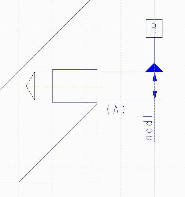

Hi all,
Is it possible to create a dimension in a drawing without a visible value?
I know you can replace @D with @S and manually type in your own in text however I would like to remove the 'add1' in the image attached.
Any suggestions would be appreciated!
Craig

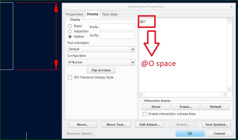

Best answer by vmráz
Yes it is posssible.
Write @O space. It´s a letter O, not number zero and 1 space afterwards.
See attached picture.
vmráz12-AmethystAnswer
September 16, 2013
September 16, 2013
Change it to @O (letter O) and a space and you will have no numbers (true for WF4 anyway)
September 16, 2013
Thanks! I was able to do this with a sketched dimension, not on dimensions created within the model. I wouldn't normally sketch dimensions but it worked for this.
