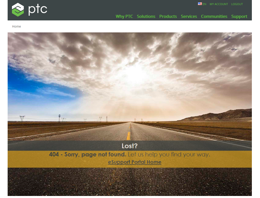

Login first and then click on the update.
If you click on the link and then login, you get:
Thanks, Dale
StephenW
April 24, 2017
You're on the highway to ... a sandstorm???  This is what west Texas looks like just before the duststorm blows in!!
