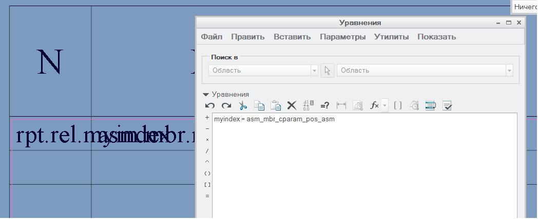

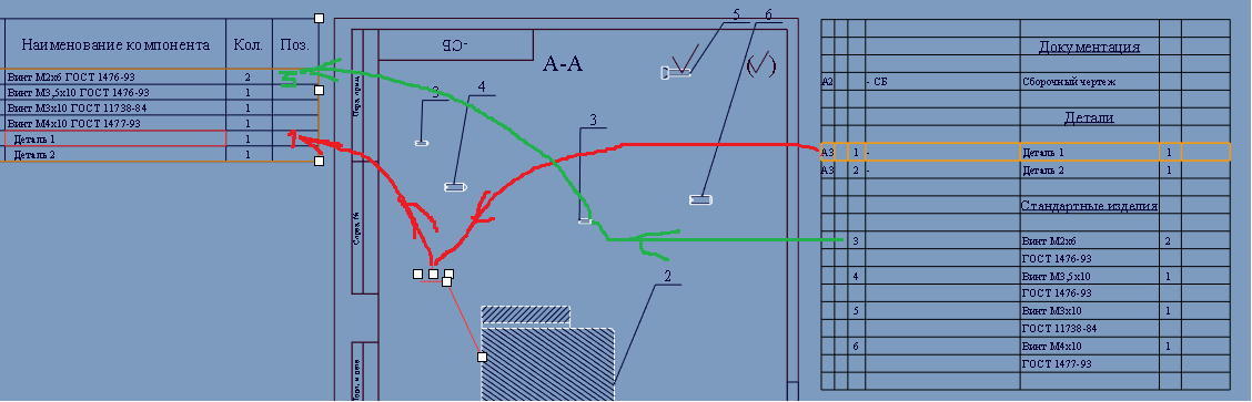

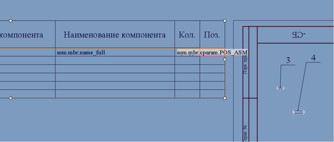

Dear All,
The problem is not entirely related to the BOM but has something to do with it. The problem is as follows. There is an assembly and the BOM formed on its basis (see the attachment below, the assembly is for visual clarity only). It is necessary for the assembly and on the basis of the BOM and BOM balloons, that have been assigned to this assembly, create a new table in which will be entered the BOM balloons (column "Поз.") already assigned to the assembly. The newly created table is also presented in the attachment. Why is this necessary? The goal is when one have large assemblies to study and the model name of the component does not match with the file name of that component, to quickly find the relevant component and its file name based on a BOM balloon. Please, take into consideration that the BOM is designed according to unified system for design documentation of Russian Federation.
P.S. POS_ASM - is the symbol name of the BOM balloon.
