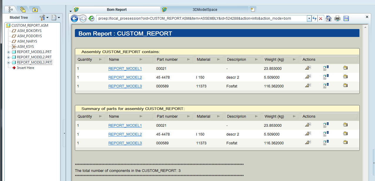

I have an assembly containing more than 20 parts. I need BOM details of CAD top level assembly and all the levels info (part no , material, description, weight) as a report. Please help.
April 18, 2011
Hello Tushar
I preprade for you file (bom_format.fmt). This file contains information for your report (part no , material, description, weight) in the assembly.
Do you need to define configuration options:
bom_format ...path...\bom_format.fmt
You can add other custom parameters the following rule: ;%parameter[-20s] - where 20 means the column width
View report: Info > Bill of Materials >> Top Level > OK >> Screen > Done/Return
