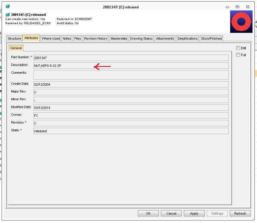

Would someone be able to please confirm for me, that the Description field in DB Properties > Attributes is the correct Text Reference I have set in BOM Table Layout?
After Drawing the table, the Description entries show up blank.
Thanks!
Mike

I found the answer by accident.
While in the BOM Editor, there's a command to Send To > Annotation.
BFG was the correct Group, and I had to re-assign the correct attributes associated with the BOM Editor columns.
My BOM Table looks the way I want now.

Hi Mike,
You're using Modeling with Model Manager and the text reference group used is BFG (local).
If you want to reference text with Model Manager values, you should use text reference group tb (global). Your description reference should be tb:DESCRIPTION.

Louis,
Thanks for your reply.
I tried that, but no luck, it didn't work.
