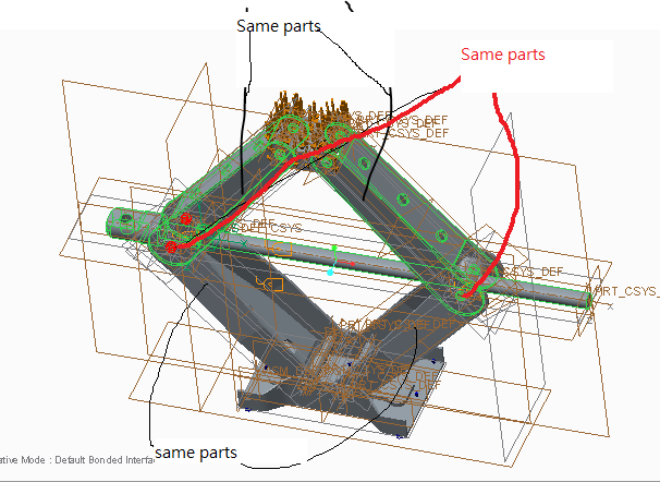

I was trying to make this car jack, but when I tried to run the static analysis it gave me the error bonded surface. I am not sure what went wrong since I use the same part twice only one of them gave me the error. I have attached the pic and model. The red circle is the bonded interface

I don't have anything that opens RAR (I avoid them).
Q: What kind of contraint are you using on the hinge point?
May 10, 2013
I used axis coincidence aline with the center bar and used distance to fix a specific location on the bar.
May 10, 2013
What if you use a mechanism "pin" constraint?
