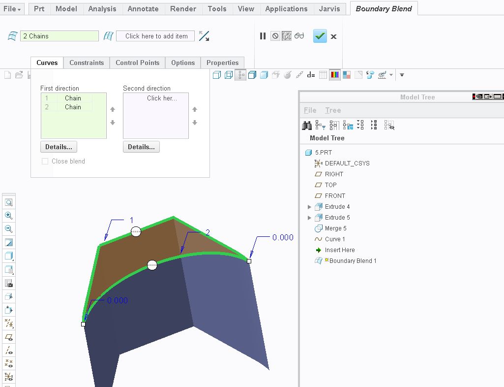

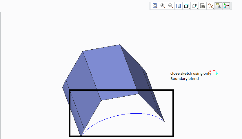

Hello guys,
        I would like to know whether we can close that portion using Boundary Blend. I know we can use fill command and style surface to close it but I want to know whether we can fill it using BB if so can you tell the step by step to do so in Boundary blend.
Thank you
Babu
Best answer by rsobecki
I see no problem to create this BB...
I used standard adding non tangent boundary using <SHIFT> key.
Maybe you wish to obtain something different?

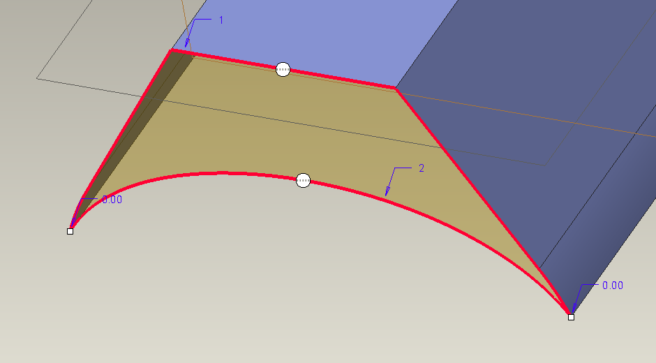

If it's planar, you don't need a boundary blend, just do a "Fill" surface.
rsobecki14-AlexandriteAnswer
January 30, 2017
January 30, 2017
Hi Babu,
Just select Boundary Blend command & select 2 chains in first direction
Pushkar

Like I said, if it's planar, use a "Fill" surface, it's a more simple. easy feature and takes a LOT less memory.
Simple is best.
