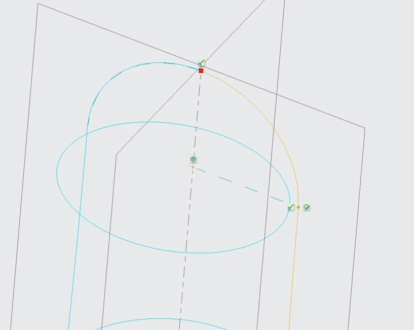

Your smaller elliptical curves aren't connected to the larger longitudinal curves. They all have to touch in order to fully define boundaries. And when you redraw them you only have to do one half. Since your finger is symmetrical you can then mirror.
DCllc1-VisitorAuthor
April 24, 2018
Hi All,
Sorry for the late response. Thank you, gmcmurray for bringing that up. I just noticed that my reference lines are not letting me make the points coincident with my oval sketch (see pic attached). As mentioned, I am very new to Creo. What's the quick fix for this?
April 24, 2018
Ahead of your sketch create a datum point at the intersection of the sketch plane and the ellipse, then align your sketch to the point.  Creo does not have the "Pierce" constraint that you may be familiar with if you've used Solidworks, so you need to create the point at the intersection ahead of time.

I wish there was a way to mark multiple answers as the solution because it took most of your help to get this done! See attached for your reference.
I built up the finger layer by layer until I noticed the problem area: the 'point' of the finger. I used a circle sketch (which I later put a diameter of 0.01mm) and switched the direction of the chain. I picked the tiny circle and went down to the layer before where as going upward seemed to work just fine for the others.
Filled the top and merged all of them no problem.
