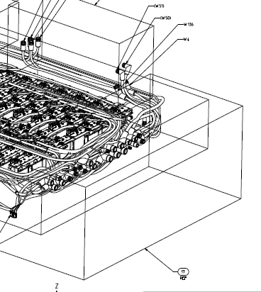

Can anyone tell me if there is a way to change the line style in a view on a drawing for a
component represented by a boundary box simplified rep. In other words I want to change
the line style of the boundary box to phantom from solid. Thanks in advance for any help
you might offer

I don't think there is any available option for this.
18-Opal
October 24, 2017
I'm not sure I understand fully what you are trying to change.  Can you please upload an image of what you are trying to change?
bgd014691-VisitorAuthor
October 24, 2017
trying to change the big box (boundary box) lines to phantom font either in drawing or in the model
