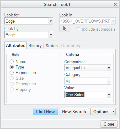

The way I find the open edges of the quilt is with the search tool:
CTRL+F to open the search dialog
Look for: "Edge"
Look by: "Edge"
Attributes = "Type"
Value = "One-Sided"
Hit "Find Now"
This will find every one-sided edge in the model and allow you to highlight them.
Hope this helps.
July 29, 2014
Yes, I have tried that. Actually that is the resolution Tech Support gave me. The find tool may find them but doesn’t zoom in on them or make points on them like the old boundary chain / from-to used to. If the gap is really small, like three surfaces not sewn together exactly, you have to zoom in on the model and pan it across your screen. Thanks for the info. Dan
