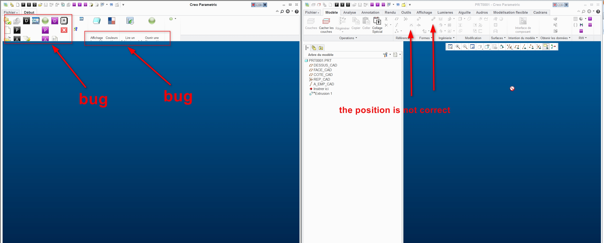

bug creo 2.0 M040 display the ribbon is not good
  • February 19, 2013
  • 8 replies
  • 5444 views
alignments icons are not correct
l'affichage des icones n'est pas correct lorsque l'on reduit la fenetre
Video Link : 3751 2013-02-19_10h56_35.jpg
http://www.sendspace.com/file/alizh2
video format mp4

I haven't had this happen yet but it looks quite annoying.
February 19, 2013
if you have a 27-inch screen, it's very annoying
February 20, 2013
It appears this is with Toolkit added icons (at least some of them). Is that correct? You may take a look at the icon size to help mitigate it, perhaps. When I narrow the window, it collapses the groups and gives a flyout.

Hi
No, it is not with icons Toolkit.
There are always tricks, but the software must run correctly.
I do not want a false solution.

You will have to work with customer service to get this resolved. If they determine this to be a real problem, they will assign an SPR with software engineering to have it resolved. If it is not a problem, they will tell you why this is happening. This is why we pay maintenance, and this is how the software gets better.

Philippe,
I didn't see anything in your post about Video Card or Driver. Are you using the latest Video Driver for your card? Your issues may be related to that in terms of Creo updating the display RAM. Also, does it happen with OPENGL and Win32 set for Graphics? Just some things to try first before calling it a bug.
