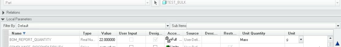

sometimes I use bulk item parts in assembly.
In the BOM table on drawing I see the BOM_REPORT QUANTITY parameter.
Is it possible to see, in the same table,
the Unit_quantity and the Unit
which are two characteristics of that parameter ?

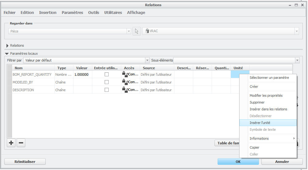

When you edit the parameters of the bulk item, you can add the column "unit" to the table to see the units. By default the parameter "BOM_REPORT_QUANTITY" has no unit. If you right click on the parameter you can add a unit by selecting like below.

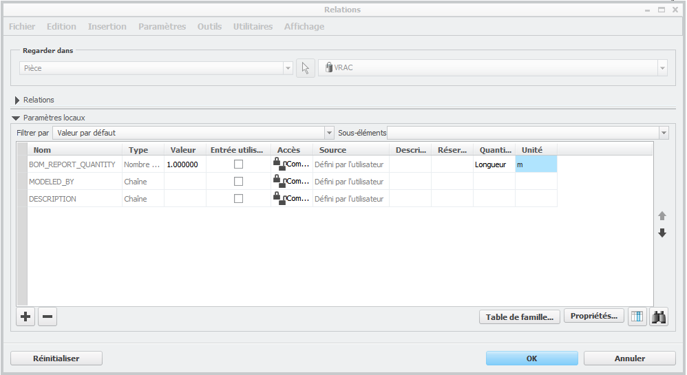

Here's what you can get ones it's done.
I suppose you can then call this in your bom table.

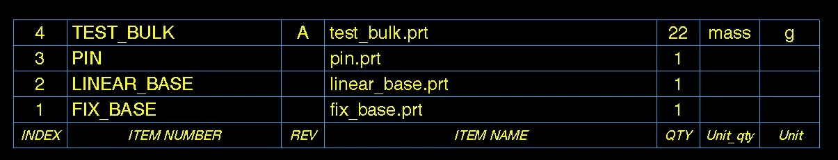

Ok, I did not read very well you question.
After a look to support, I found this : https://support.ptc.com/appserver/cs/view/solution.jsp?n=CS122116&art_lang=en&posno=1&q=report%20unit&ProductFamily=Creo…
It says :
  • To obtain the appropriate result, add the Bulk Item to an assembly and create a drawing which contains this assembly.
  • Create a table with a simple region and add the parameter &asm_mbr_ptc_unit_bom_report_quantity
  • Refresh the table
