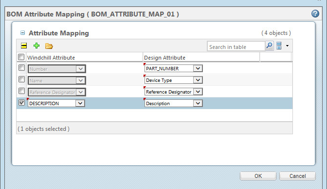

We have setup a BOM Attribute mapping, and found out how to add more rows to that table in order to map Global Attributes (which are inherited by the ECAD Document type as a sub-type of CAD Documents… which we already setup for MCAD), along with the additional configuration as per CS53983.
The PCBCAD Design Attribute "PART_NUMBER" does already have the value of the Manufacturers' Part Number in each component instance (and we will change Windchill Name to be the same the next time we edit this mapping file).

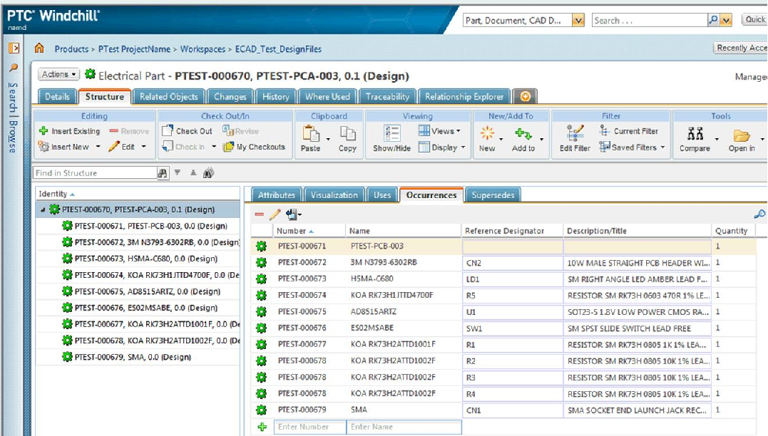

When we use this to generate a BOM from a Schematic, we get the following result - and the problem we have with this is that the new Elec Parts made by the generate BOM function have been made with new Numbers based on our Elec Part OIR as they were not already present in Windchill, rather than the Manufacturers' Part Numbers as set by the BOM Attribute Mapping.  I think this indicates that the Elec Part OIR is overriding the BOM Attribute Mapping.
Our Elec Part OIR is set to use a numbering scheme that will be appropriate for the new Parts needed to go with PCB's and PCBA's, ie. when we build and associate Parts with the ECAD Documents for Boards and Schematics.
My understanding (and hope) is that if we have already loaded the Elec Parts into a Windchill Library with the correct Name & Number, then the Generate BOM function will spot that they exist already and not create new Elec Parts using the OIR (which will also store them in the active Product repository), but instead make links to the existing items in the Library.
The crux of this question is how to use Manufacturers' Part Numbers for components on PCBs but our own Part numbers for the Boards and Board-Assemblies that we design.

Ahh, now I follow fully.  I missed that the OIR was giving you numbers that weren't the Manufacturer's PN, but that makes sense.  Yes, if they exist in WC, then it will automatically use the ones that are there.  That's what I'm doing.  As I'm guessing you know, PTC has a tie-in gateway with Cadence ADW (or EDM depending on what version you are talking about) for library sync, but they do not have a similar option for Mentor tool users.
I am using Cadence and have the gateway configured, so I know a little about what's going on in the background.  Maybe that can help a little.
Basically what happens is out of Cadence, I get an XML file with all the information from the library.  Then, there's an Infoengine task that runs and takes the XML file and creates new parts or updates existing parts and maps the metadata fields from the XML export to attributes in Windchill.  The gateway actually has a method to send parts and metadata back to Cadence, if you want, but I'm not using that piece of the tool.
So, going back to your original question.  Yes, if you can create a copy of everything in your ECAD library in Windchill, then an ECAD design should use the same parts, if the Part Numbers match.  Now, how to do that without the gateway, I'm not really sure.
