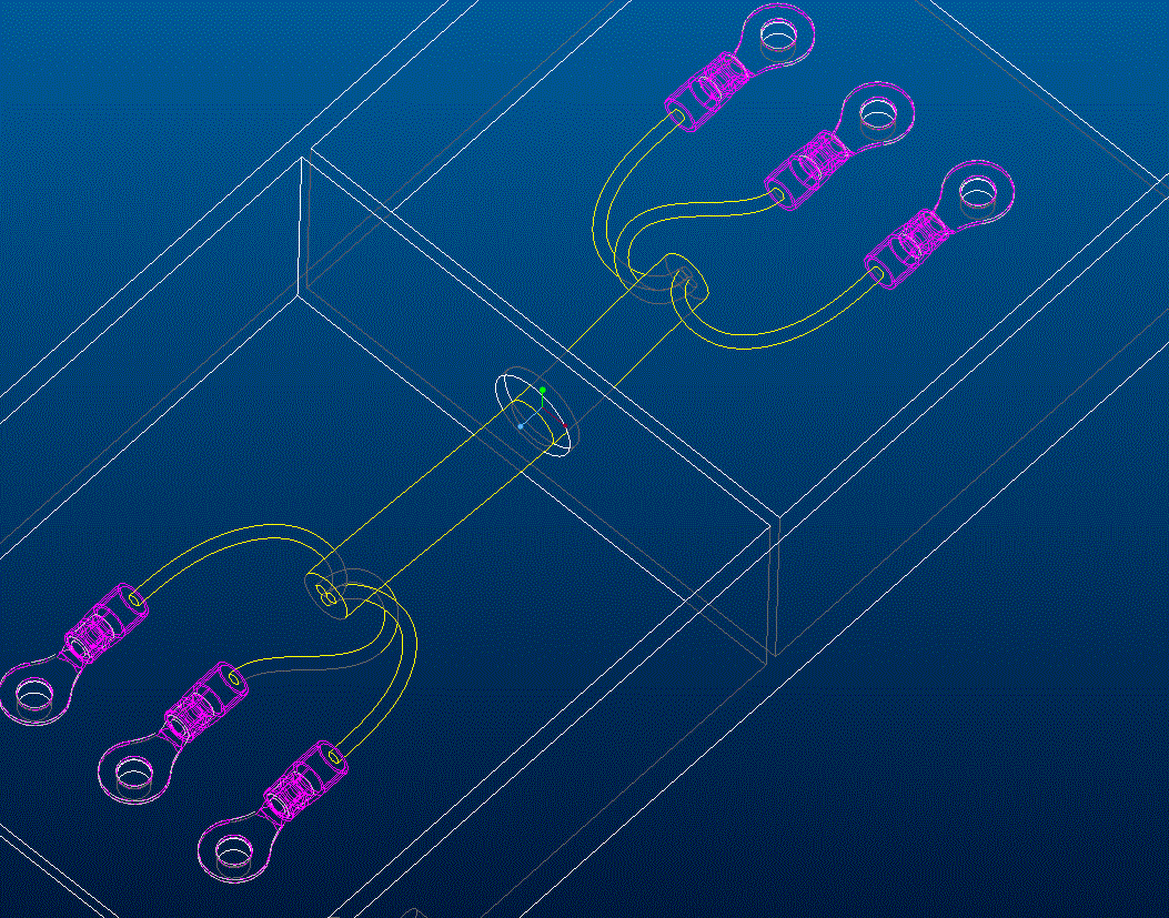

I'm just starting to learn cabling. I've created a 3 conductor cable and placed it into an assembly. However, the conductors that come out of the cable are going in the wrong direction and for the life of me, I can't figure out what I'm doing wrong. Please look at the attached screenshot and point me in the right direction.

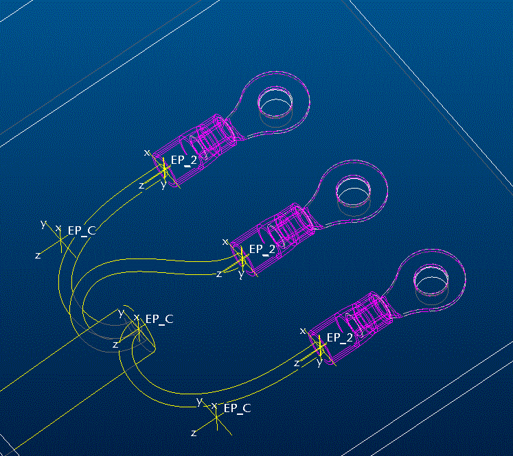

I’ve attached another picture with the entry port coordinate systems visible.
When I follow these steps, I get the conductors exiting the cable in the wrong direction. What am I missing? I can't find any way to "flip" the conductors so they exit the cable in the correct manner.
I've tried reducing the bend radius and moving the cable entry port CSYS further away from the wire entry port on the connector and reversing the Z direction of the cable entry port CSYS. None of these things had any impact on how the conductors exit the cable. I must be doing something wrong, but I’ve searched this forum and Google to no avail.

Minimum bending radius for spool seems to be set too high, you can try to lower that value.

Just a SWAG, but maybe it has to do with the distance between the
terminals and the cable exit point, and possibly the radius of the wires
coming out of it. I don't think you can control that radius, but may be
moving the terminals farther out will fix it.

Your csys is reversed. Flip the EP_C so the Z is reversed

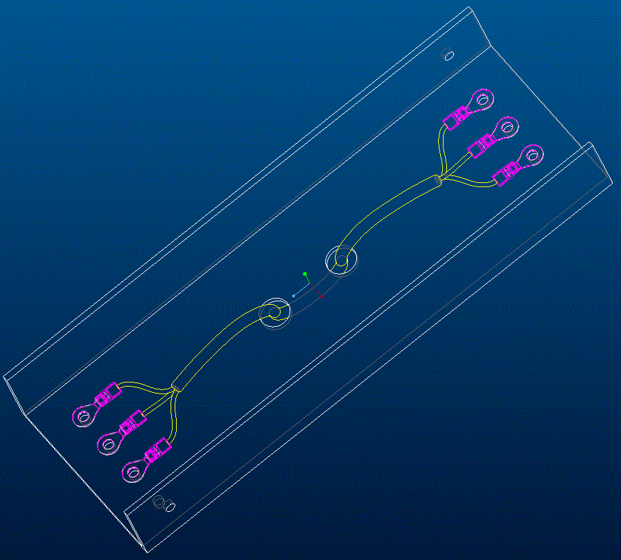

With help from the guys at SW Research Institute, I finally figured out my problem. First, you can't use a 3 conductor cable and route it to 3 different connectors. I was trying to route the cable to a entry port (round) and the conductors (wire) to different connectors and nothing was working.
Here is what worked. 1) Designate the entry port (wire) on the 3 connectors. 2) Create a network route using points. 3) Insert 3 wires using the via network option. This routed all 3 wires correctly. 4) Create a bundle specifying the end points of the network route and a new spool.
I've attached an image if you are interested.

Ok, I stand corrected. What I was missing all along was the right-click in the From/To selection boxes and getting the context menu that allows me to select a location. Assigning the cable to the entry ports (round) is definitely the wrong thing to do!
While bundling still works, the method Jim demonstrates is much easier...
