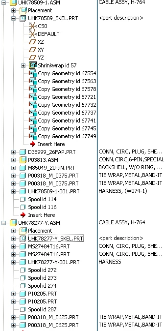

I'm just starting out using RSD 8.0 and Pro/E 4.0 Cabling.
What's best practices to setup the cabling assemblies structure?
Here is my currentassy model tree setup:
- AircraftInstallation CableAssy
- Skeleton Model .prt
- Shrinkwrap (Aircraft Top Level Assy)
- Cable Assy 1
-Copy Geometry (p-clamp location)
- Cable Assy 2
Is this correct? Or is there a better way?

I do:
Top Level Assy or Sub-Assy
-Cable management if installed at assy
-Harness Assy 1
--Skeleton (shrinkwrap, copy geom...)
--Connectors/Componenets (all csys defined for entry ports)
--Cable part (.prt created when making harness)
---Sub-harnesses defined
-Cable Assy 1 (for mostly purchased cables)
May 3, 2012
Sun,
That works too. It all depends upon how you want it to look from a BOM structure. I make everything independent, mostly use datum features and curves to place the network. I prefer a robust cable assy to a parametric one. Redefining failed components when something changes isn't too bad but missing references to cable or network locations are a pain to resolve. If something changes you can redefine and make it dependent to update the copy or shrinkwrap; then make it independent.

Anyway, I know that Jeff's assembly structure is good with one harness assy, but what happen if I have two or more harness assy under a Sub-Assy?
Below is my current cabling assembly structure with two cable assemblies:

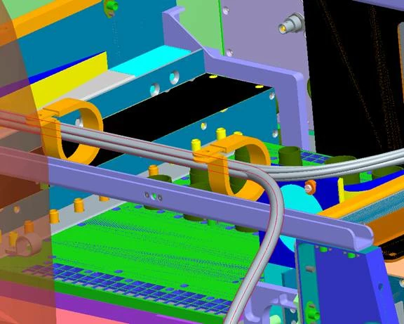

Here is a snapshot of two cable assemblies that I've created within a Sub-Assy:
[cid:image004.jpg@01CD2900.1426AC30]
Is there a way for me to setup the Cabling structure, so that Pro/Cabling would know there is already a cable assy at the same p-clamp location and separate them, not merging together?
