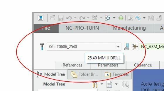

I am currently trying to automate my process a bit more by using a spreadsheet to generate a relations file, and then paste this into my template.
I have got feeds & speed, datum planes and hole depths sorted, working well.
My next step is to generate the tool numbers in the relations file, to control the tool selection for the sequence.tool sequence.JPG
Has anyone done this before, is there a way to control this with parameters?
