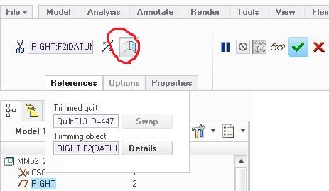

Depending on the surface geometry, the silhouette surface may or may not be selected. Creo is pretty good about it, but some still can't be used.
You can, however, make a copy of the surface and use the trim tool to trim it back to the silhouette edge. You need to select the surface quilt and a plane first, then look for the silhouette button on the trim toolbar.
