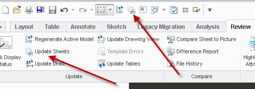

Also, if I amend a part, should the drawing automatically update when I next open the drawing? at the moment, when I open the drawing for an amended part the dimensions all move to the new locations, but the features appear to remain in the old position. How can I refresh the drawing as the regenerate button doesn't make any difference?

You can not open a drawing directly from a part or assembly.
The drawing refresh is the chase your tails icon "UPDATE SHEETS" under the review tab or I added it to the quick toolbar.
There is an option to regen the views automatically AUTO_REGEN VIEWS YES.
By default this is turned on. Some users turn it off to speed up the system to not have the drawing regenerating views until they are told to. Its important with large assemblies and complex part models.

How do you add the button to the quick toolbar?
I did check and the AUTO_REGEN VIEWS is set to YES.

Right mouse button on the quick access toolbar gives you the option to customize it.
The toolbar is mode* sensitive so items you add to the drawing quick toolbar don't add the other modes toolbar. This can be good and bad. There are a lot of modes you want to have the same options on but it does give you pretty much infinite control over what shows up in each mode.

You can also get to the Update option faster by putting your mouse over the drawing Sheet tab (normally at the bottom of the screen when the drawing is open).  Bring up your right mouse button and choose Update
