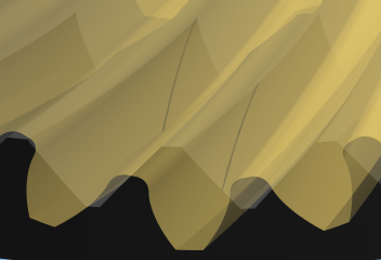

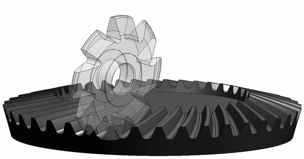

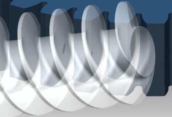

Can creo do this ? worm/helical gear in UG by mathematical modeling
  • May 17, 2014
  • 2240 views
all by mathematical modeling
May 17, 2014
I am going to assume you need the manufacturing extension. We have discussed solid tool material removal along a toolpath in core Creo. The results meant some very extensive operations to achieve proper results.
May 17, 2014
One has to guess - all computer modeling is mathematical.
I do like the black/dark edges on the parts. Does Creo do that?
When making presentations, it was always, copy Pro/ Engineer screen, paste to Photoshop, select edge color, fill-black.
yes
