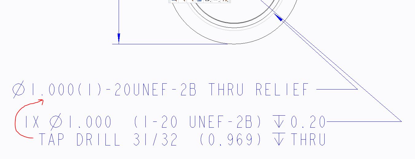

I have made some effort to modify hole note callouts with the DEFAULT_CALLOUT_FORMAT_DATA option.  However, I don't like how the notes don't look like dimensions.  Is there a way to place the notes within the diameter dimensions of the hole, so that I get parameterized information but in a dimension?

I can add text and parameters to my dimensions, however, what I wanted to see if and how to do was to place a standard hole note callout (defined in a .hol file) in the text body of the dimension.

Yes...but, you would need to modify the actual hole dimension, not the annotation (setup note) via the callout format.  All the annotation parameters are buried right in the feature itself, you just need to reference them in the dimension text.  Basically you configure one hole the way you want it, then save it as a UDF.  Then, every time you place this "custom" hole UDF, the dimension will display the information you want.
