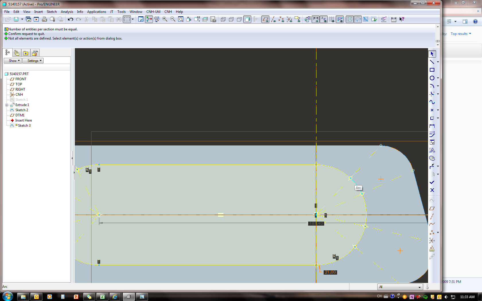

Can I reconnect divided line (entity)?
I divide a sketch during blend feature, but I found my divide wrong, so I need to reconnect the line which alrady was divided. My question is if the divide is permanent. thank you.
Best regards, Hongjie

Hi
I dont think there is an option in pro-e to join(I have never used)
Better you delete extra segments and use Corner option
Regards
K.Mahanta

Hongjie1-VisitorAuthor
January 13, 2012
got it, thank you.
