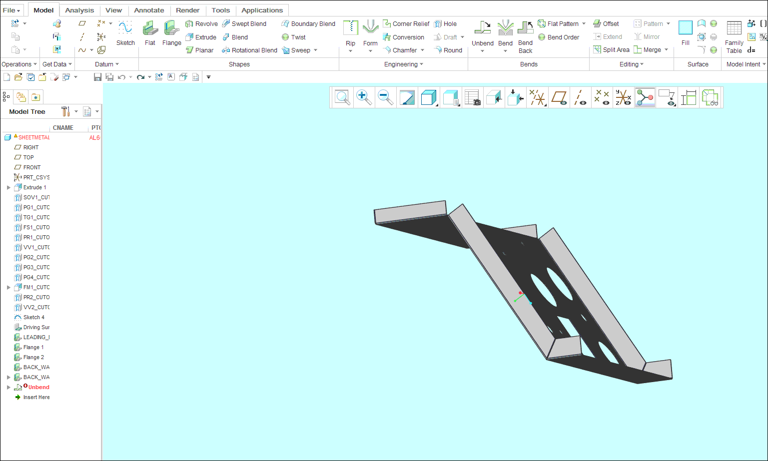

If there is a sheetmetal expert out there, could you open the attached file and tell me why this sheet metal model will not unbend or flatpatteren.
Not sure what other information you might need, just let me know.
Creo 2.0 M090
Windows 7 64bit

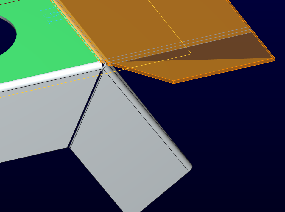

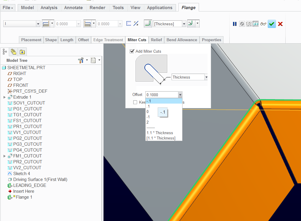

I ran into this the other day. You have an interference in the corner of flange 1 and flange 2.
Change the miter to "-0.1" on both and it will unfold properly.

You really are a sheet metal expert. I have been fighting this thing half the day! Thank you very much.

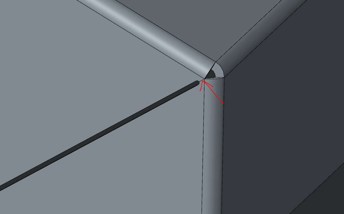

Ok, now does that mean I had overlaping geometry or not? And what is the purpose of the small touching surfaces, are they supose to be there? Keeep in mind i am not a sheetmetal guy.
October 21, 2014
Normally a shop would put a round punch right there to get a minimal bend relief. However, they do need some clearance because the need to overbend the part to have it relax at 90 degrees.

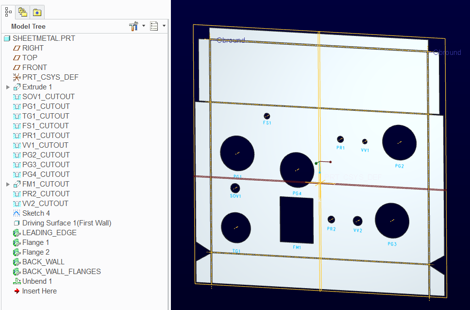

The reason the unbend fails, is because of the accuracy.
In sheet metal it is recommended to use absolute accuracy (which now is the default for sheet metal parts), and not relative.
In this part, the thickness is small compared to part size, and since the accuracy is relative, at some point the part size is big enough to make the accuracy too big to properly create the reliefs, which contain small edges which their size is proportional to the thickness.
You can see, if you make the part smaller by changing some dimensions, the unbend will work. For example if you change the height of wall BACK_WALL from 10 to 5, the unbend will work.
