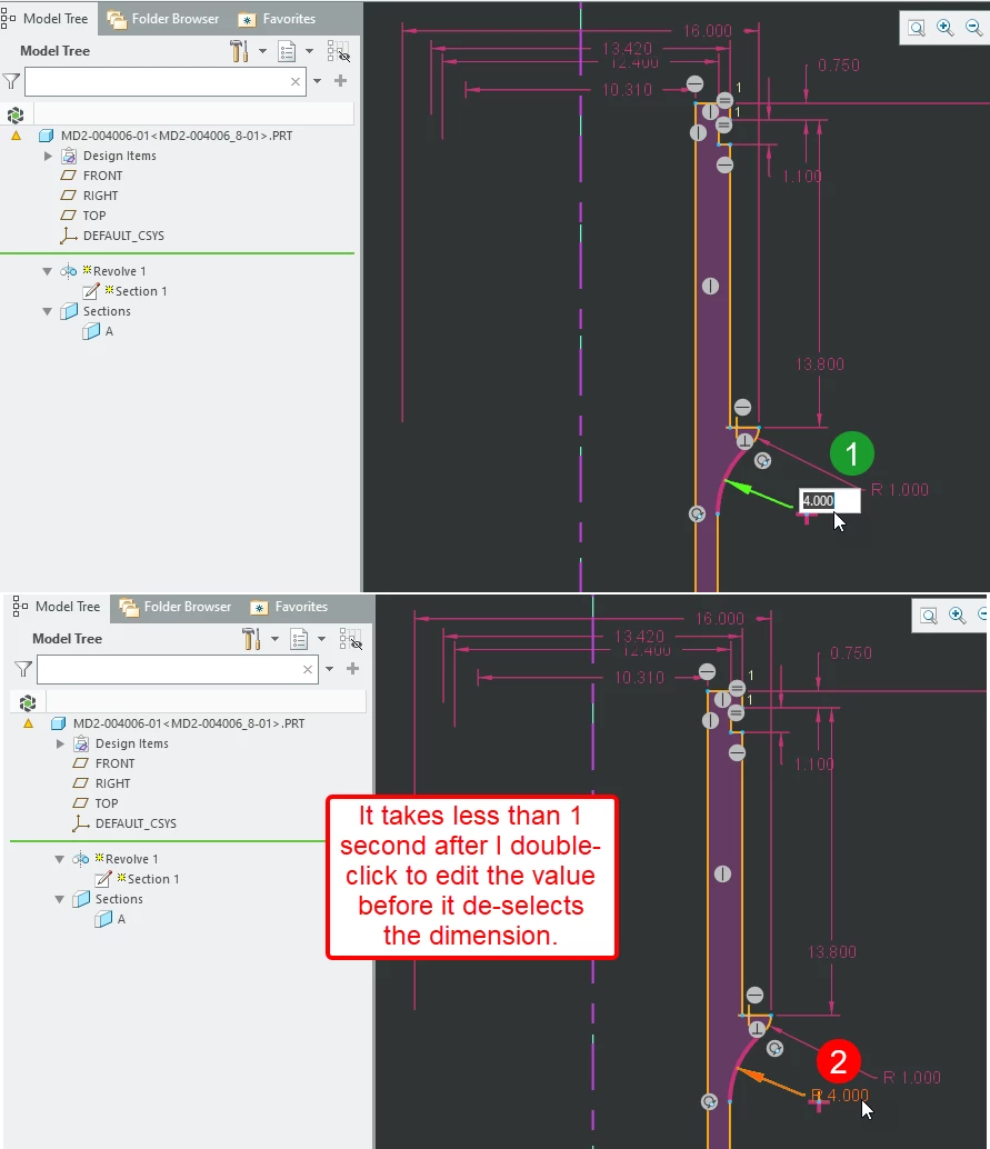

Can't enter dimensional value after double click in model sketch
We are currently using Creo 8.0.2.0, and when I double-click on a dimension to enter or edit the value, the prompt comes up and then immediately disappears (see attached images).  I have less than one second to try and enter a new value.

One of my coworker has the same issue on her CREO 7.0.12.0.
My other coworkers an I, with the same version of CREO 7.0, doesn't have this issue at all.
It appears randomly on her computer : sometimes it works just fine, sometimes the double-click edit doesn't work.

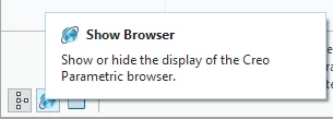

Quick fix:
Select Show Browser and close all of the tabs.
Long term fix: add the following to config.pro:
enable_3dmodelspace_browser_tab no
enable_partcommunity_tab no
enable_resource_browser_tab no
enable_punditas_browser_tab no
web_browser_homepage about:blank
See this discussion: Solved: Re: Cannot edit dimensions in sketcher any more - PTC Community
And this article: Article - CS378868 - In Creo Parametric Sketcher mode, impossible to enter a dimension by double click, the menu is exited automatically. (ptc.com)
March 18, 2024
Thank you, the line "web_browser_homepage about:blank" worked.
