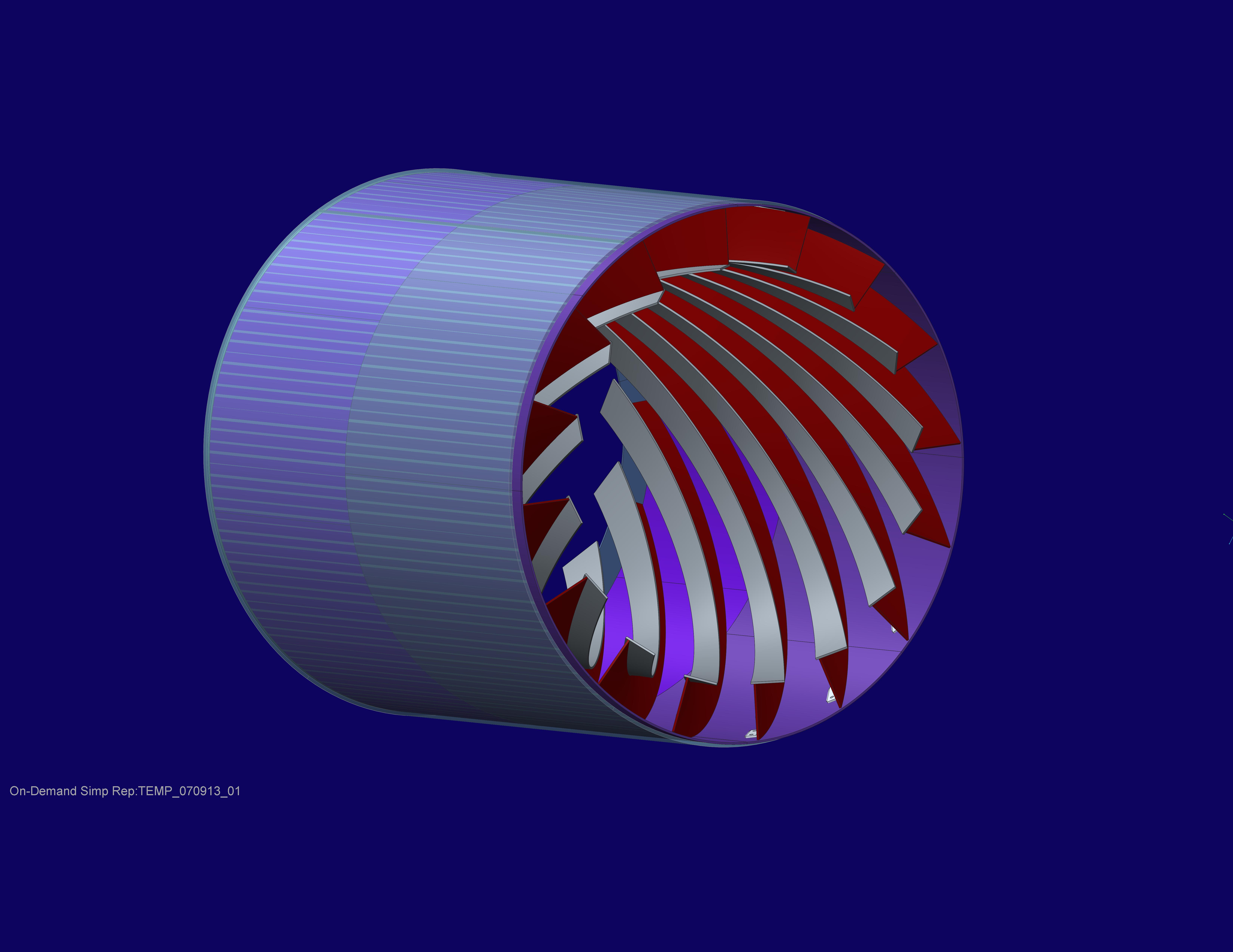

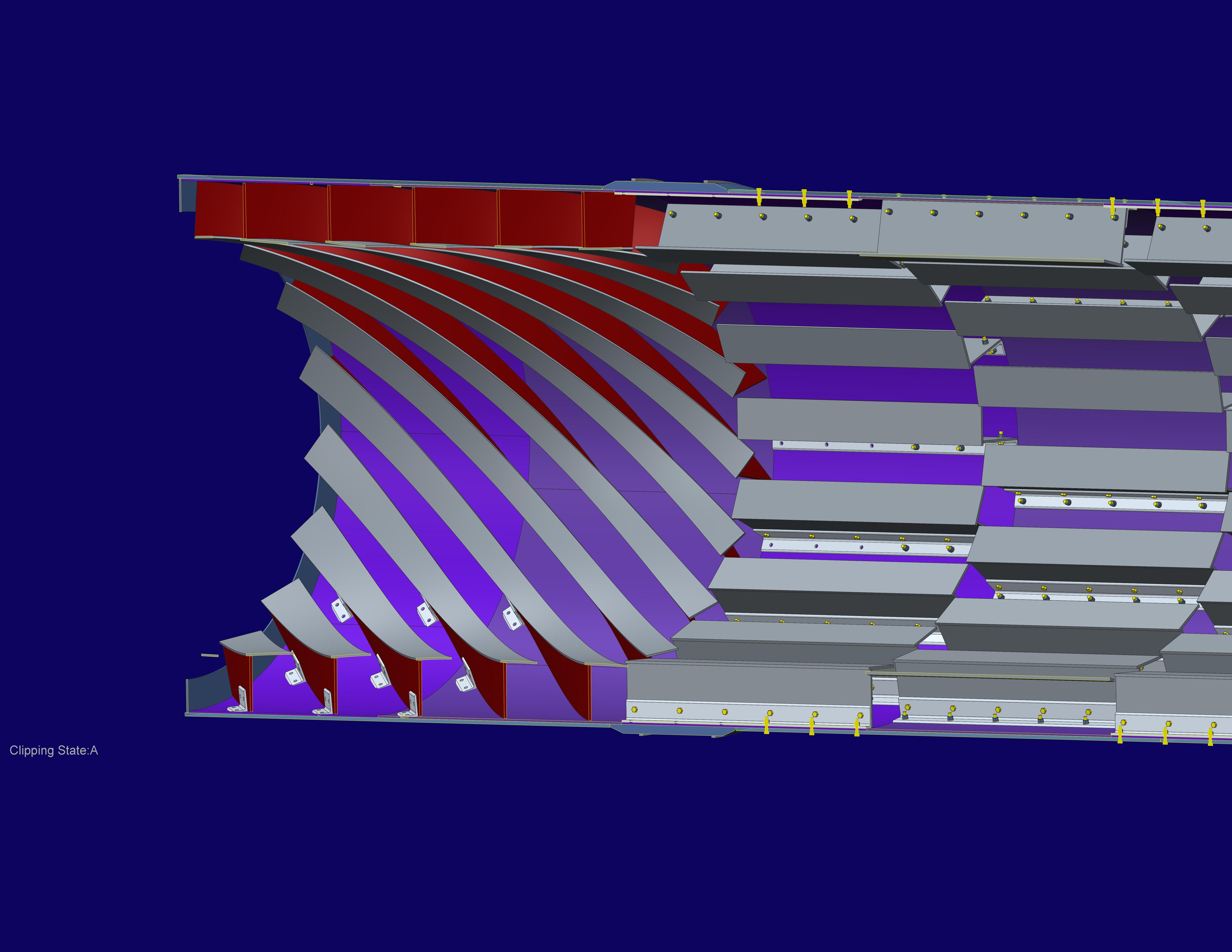

This is probably elementary for most of you, but I'm working on a large dryer unit that has feed lifter blades on one end. I have managed to create the parts using a helical sweep (for the vertical leg) and a swept protrusion using an edge of the vertical leg (for the horizontal top plate) both in sheetmetal mode, however, I can't get them to flatten out now. Any ideas? The I.D. that the vertical wall attaches to is 95" and the travel down the drum is 8' at 45 degrees. The vertical leg is 10" x 3/8 THK. AR400 and the top plate is 6" x 3/8 THK AR400.
**** ADDER**** The vertical leg must be normal to the surface of the drum at all points along the curve and the top plate is normal to the vertical (obviously).

Frank is right, there are a lot of scenarios where you can no longer unfold sheetmetal.
I don't know how accurate you need these, but I might suggest offsetting the surface (distance 0) (in solid modeling) and flattening the quilt. It has some pretty good options for projection options. It will give you a relatively accurate flat pattern.

Ahhh, geometrically, a helical surface is not a "ruled surface", and thus is not developable, or able to be "flattened".

The responses you got are all correct and good advices (use flatten quilt as helical surfaces cannot be unbend)
