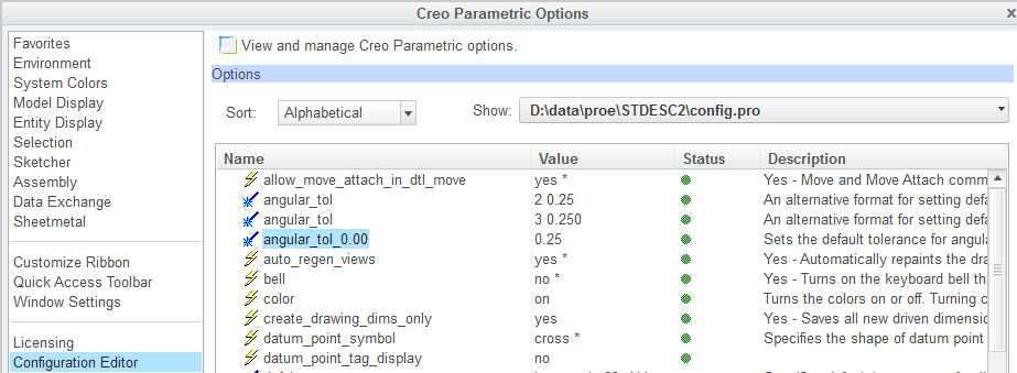

I'm trying to change the angular tolerance to 2 decimal place.  When I edit the value on screen at the bottom right I can type in 0.25 as an example but it is clearly changing the tolerance only 0.0.  I thought if I type in 2 decimal places it would change the setting, since I couldn't find where to add 2 decimal places.
I tried changing it in my configuration editor to 0.25 with no success.  The reason I know it's not working properly is because when I read it in my drawing using "&angular_tol_0_00" it displays 0.50.  Does anyone know how to fix this issue?

‌The options in the config file are only applied when creating a new empty part.
Sep 3, 2016 5:51 PM UTC
‌To change the values for a part that is already created try adding annotation elements for the tolerance value settings you want to change. This will allow you to change the value.

If I'm understanding you correctly you want me to add a second angular tolerance below to get the 2 decimal places.
Right now (picture below) it has angular_tol_0_0, but I need to add angular_tol_0_00.  How do I do that?
Sep 7, 2016 4:01 PM UTC
You add an annotation element to the screen for a note that has &angular_tol_0_00 from the annotate tab. I don't believe there is a way to add it to the list of tolerances displayed at the bottom of the screen.

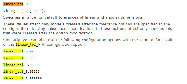

Config parameters linear_tol_0.xxx and angular tol_0.xxx only take integer values (0-9).
So I prefer to use config parameters linear_tol and angular_tol. Because they are more flexible.
And as it was mentioned before, the tolerance values from config are applied only to new/empty parts.
The default values in config will not matter, if you use a template.
