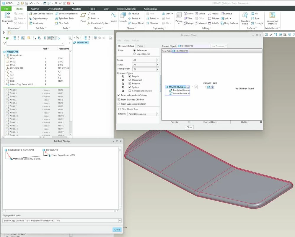

    Mar 4, 2026 6:08 PM UTC
    You left out details on the method you are attempting to use to copy the surfaces between models. I assume you intend to use copy geometry functionality. I was able to copy the surface using external copy geometry to a new model as shown below in Creo 10.0.9.0 .
    ECG from reference modelECG from reference model
