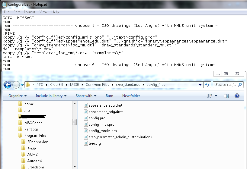

I have recently installed PTC Creo because my college uses it. As we are in Europe we need to use the European standards. I tried setting the 5th standard from "configure.bat" but it didn't work. I have run it as an Administrator and it shows "0 file(s) were moved". Could someone please help me set it to European standards? I am using Creo 3.0 on a Win 10 PC.

It looks like either you are not starting this batch file in the proper directory or the path is not set correctly.
It says that you need to navigate to the "creo_standards" then run the configure.bat
As this is an output from the execution of the batch file, I have no idea where or what this program is looking for/at.
You might want to verify that files exist in
c:/Program Files\PTC\Creo 3.0\Common Files
If you altered the location of the Creo install location, you may need to modify the batch file to reflect the new location
that's all i got for now...

I am running it from this directory: C:\Program Files\PTC\Creo 3.0\M070\Common Files\creo_standards
Here are all the files from that directory:
April 4, 2016
Here is the only thing this configure.bat file is doing when you select "5". (if you understand this)
First, can you verify the file "config.mmks.pro" resides in the folder as shown above?
