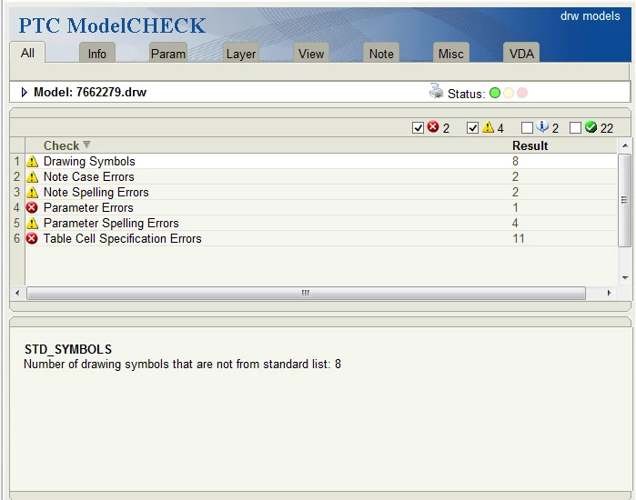

Hi All,
I have configured model check to check the non standard symbols on drawing sheet.
As per the attached image, result comes in numbers.
For example:
STD_SYMBOLS
  Number of drawing symbols that are not from standard list: 8
Can we highlight these non standard symbols?
Thanks & Regards,
Y S Srikanth Kashyap
Best answer by DonSenchuk
Based on your screen shot I have to say no. If the listed warning doesn't allow a correction I don't believe any other changes to the model check configs will change that. I also don't recall seeing anything in the manual about correcting symbols.
June 19, 2015

Srikanth,
STD_SYMBOLS will report error/warnings as information referring the list for DRW_SYMBOLS in start file. Highlighting for such symbols is not possible.
I think information provided by Don is good enough to answer your query.
