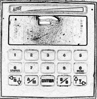

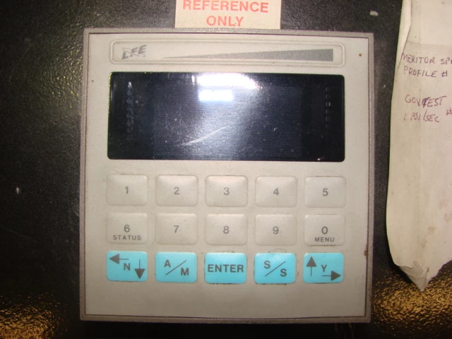

Can we import a jpg or bmp into ProE for tracing and getting a design started?

Open the picture in Photoshop or GIMP (Free version).
Apply Edge Detect filter.
Save picture as a pdfand upload to:
http://www.pdftodxf.com/

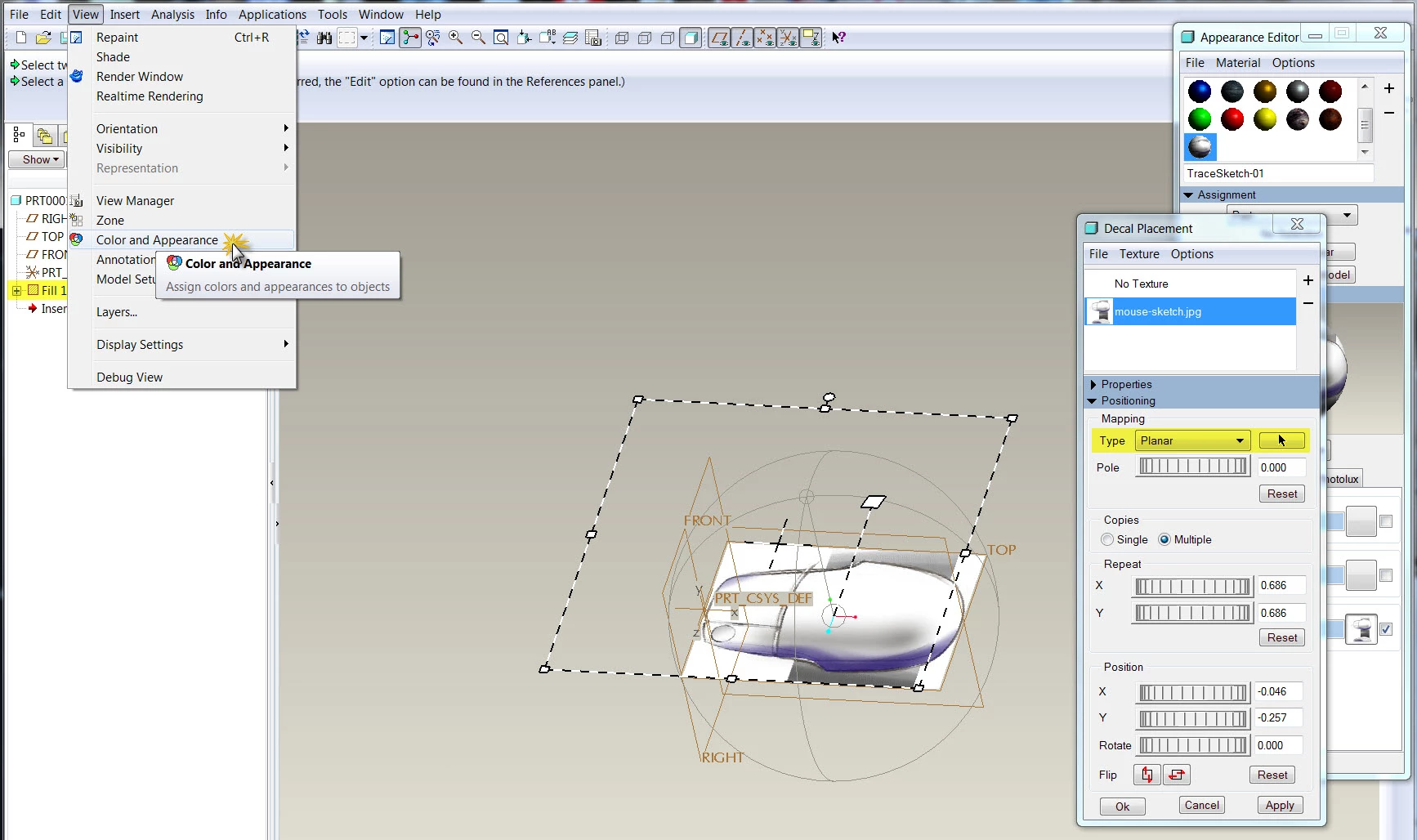

Crop the image to the edges of the item. Create a surface as large as the item and make the surface match the width and height. Place the image using a decal texture via a color.
This is useful for place-holders as well. Rather than model all the keys on a keyboard, just place a photo of the keys on a keyboard shape.

For people not having ISDX the workaround would be to create a planar surface and map the image on the Surface via "Colors & Appearances". Map the Appearance as a planar map. Create the Planar surface to scale and stretch the image to match the edges of the Surface.
But TraceSketch is the best option.
