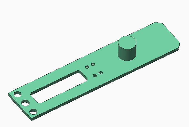

Is there a way to move created features in Creo?
It appears you can copy and move items but I'm not seeing how you can just move features to other locations without the copy.
If so, can you move all features, even datum planes?

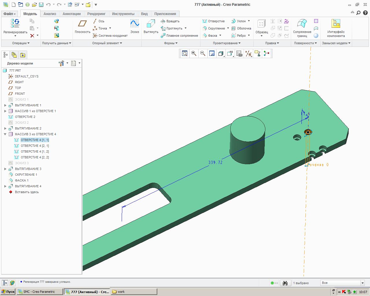

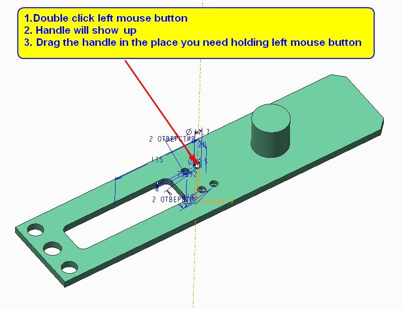

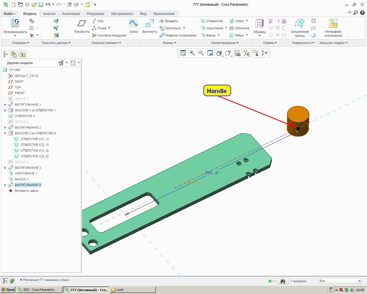

If you'd like to move created in Creo feature you should double click on it by left mouse button. The handle will appear. Move this handle in the place you need holding the left mouse button and drop it. The feature will change its position.

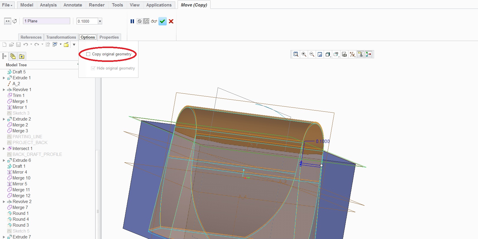

Today I stumbled on what I think my answer is.
I was ready to submit an Idea for "moveable quilts" when I looked closer at the Copy command.
I was overjoyed to find the attached Option toggle.
I'm crossing my fingers that this is exactly what it appears to be. This will be huge if this is actually possible.
Perhaps there might be others out there that this would help.
August 15, 2013
Moving surface geometry (a quilt for example) is entirely different than moving a feature or solid geometry. Move/copy quilt has been around forever. You cannot however use this to move a feature, only create a copy of the feature and then move the copy.
