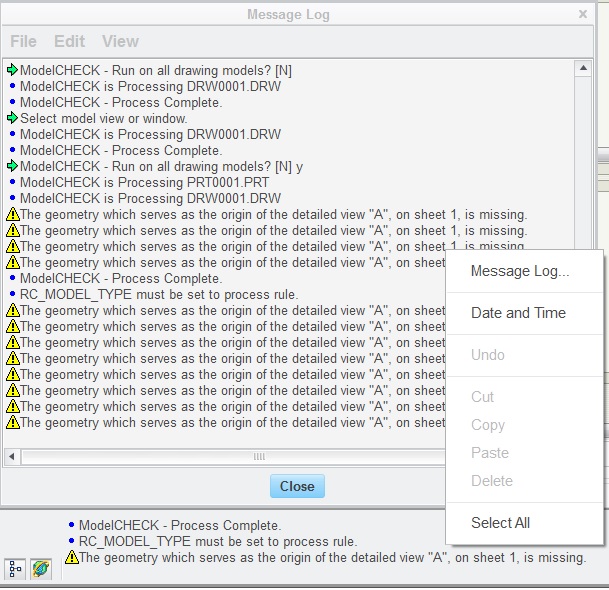

The drawing is in fact new, and has not been checked in yet. When I open the drawing it does show missing references however they flash on the status bar so quickly that I cant really catch what it could possibly say. So I am attempting to trace the missing refernce down by view, however Im not 100% sure how to go about this.
Is there a way I can click on the view and check to see if there's a missing reference or something? because otherwise I really cant check for anything. I've went to each view and looked through their properties and individual information but found nothing relevant or pretaining to missing references or the problem part.
I did however find the Model linked to the drawing. I went to Layout→Drawing Models→ and looked to see what models were linked to it and the problem part was in the list. I dont know why because again its not being used. So I deleted it, updated it and tried to remove the problem part again. However it still says it has a parent item associated with it that wont allow for it to be removed. I was pretty confident that this would have fixed my problem but apparently not.
How exactly do you go about looking a view references?
Thanks again for your time and help
jbailey
18-Opal
July 8, 2014
If you right click in the message bar, select "message log" and that will give you the entire log.
