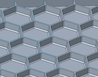

I am looking for an automated way to create a cellular array of ribs and have run into what seems to be a limitation with trajectory rib functionality. The first pic below illustrates an example of what I want to create but I am not able to use the projection of the patterned hex curves in the sketch for a trajectory rib without manually selecting each hex.

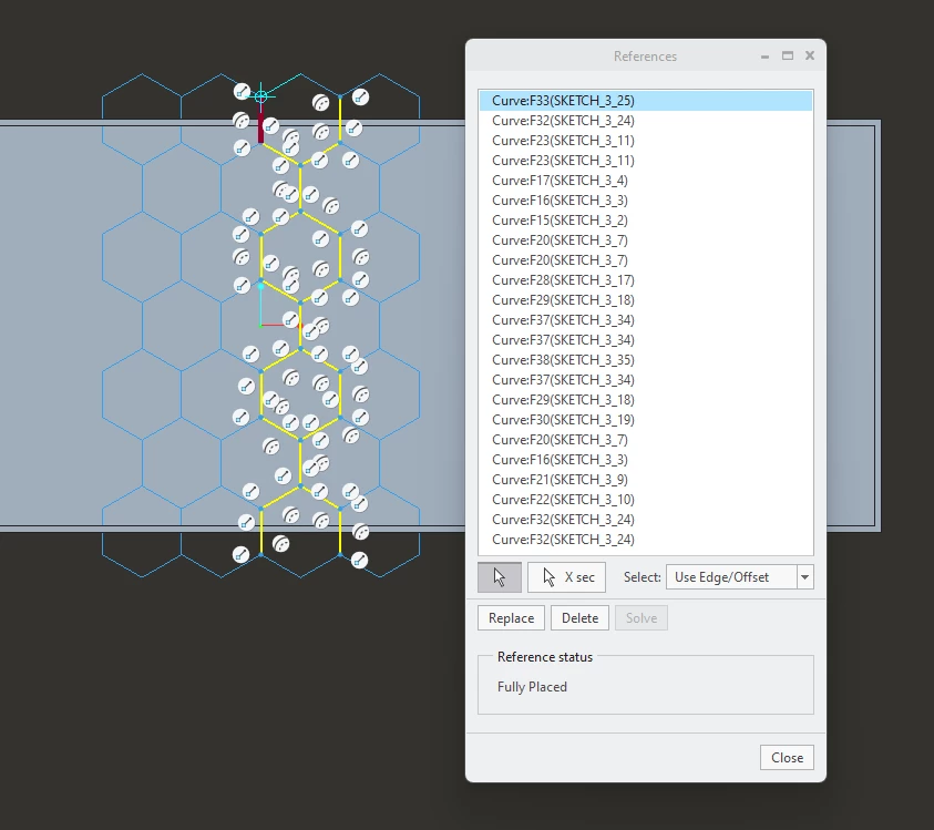

I am able to generate a pattern of cells that "should" be available for use when defining a sketch for trajectory ribs. So far, I am not able to select the cell array with a pick box or intent reference selection. Am I missing something with sketcher selection or in the projection tool within sketcher?

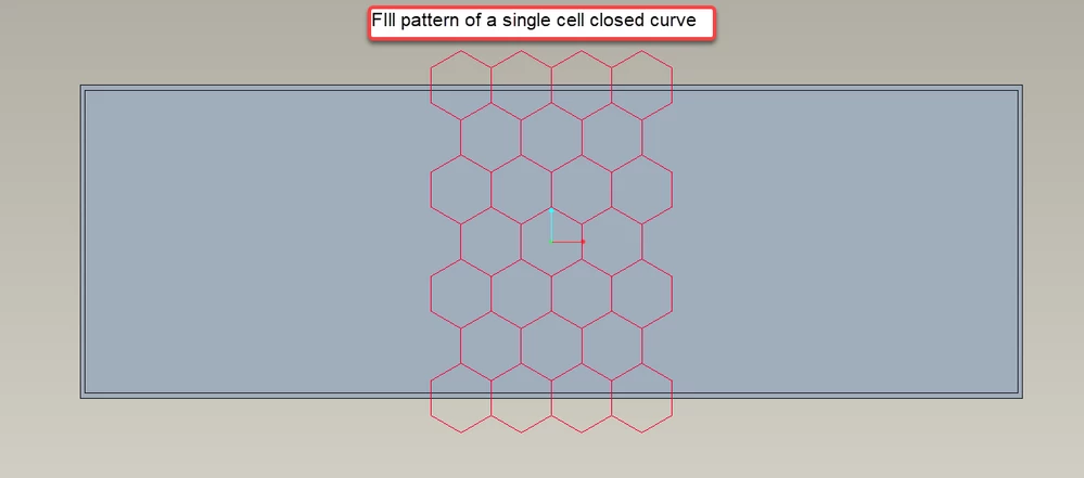

Is there a better way to approach this from a modeling standpoint if I want it to be more automated? Using a fill pattern, I can generate the array from a single sketched hexagon and a few feature relations. It would be nice to leverage that and generate the ribs based on this pattern.
I need a way to select all of the cells using "all curves in feature" or similar when defining the sketch for the trajectory rib for this approach to work.

Creo 7 test case model for reference. I am trying to use the cell array to generate trajectory ribs in the shell.

@MartinHanak thanks for the model. What you had to do to pattern this was exactly why I submitted this query. It requires the manual selection of patterned curves to be used in a sketch for a trajectory rib.  I am looking for a way to select all curves in the array for use in the sketch which may not be possible currently.
From PTC documentation on sketch for trajectory rib:
Sketch one or more lines, splines, or arcs to define the rib feature trajectory. The sketch can contain any number of open, closed, and self-intersecting curves.
