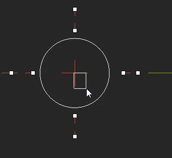

Is there a way I can easily adjust the size of a Center Mark on my Creo 4 drawing besides dragging each endpoint individually?

Under the annotation tab, select the center mark.  Then move your cursor to the intersection of the centerlines and drag from there.  This will drag all four ends at once.

When I move my cursor to the intersection and try to drag, all I get is a selection box...

please attach a picture describing your "situation".

Select the center mark then position pointer over one of the lines of the center mark and drag the line out from the center to adjust all four ends together.
