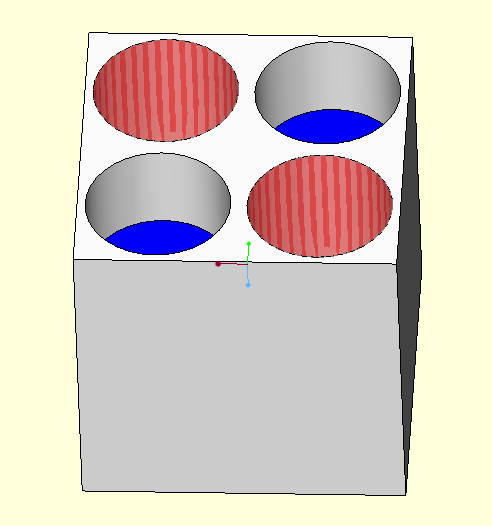

December 11, 2015
Works fine with a simple boat including 2 balasts (blue) plus 2 empty (full of air) cylindrers. (red)
Sensitivity studies for both weights (full boat with partially filled cavities and empty cavities).
In this simple example, the "boat" will be around 70.8 mm deep in the water.
When the level in the partially filled cylinders is 60.8 mm (the thickness of the bottom is 10 mm) the mass of the moved water is equal to the mass of the boat + the air + the water Inside.
The empty volume must be full of "air" to be taken in account when the water volume is calculated.
The boat "cut" at the level of the water inside the cylinder => give the volume of the moved water (of the sea) => when both masses are identical, the steady state is reached, giving the buoyancy level.
Hope this could help !
