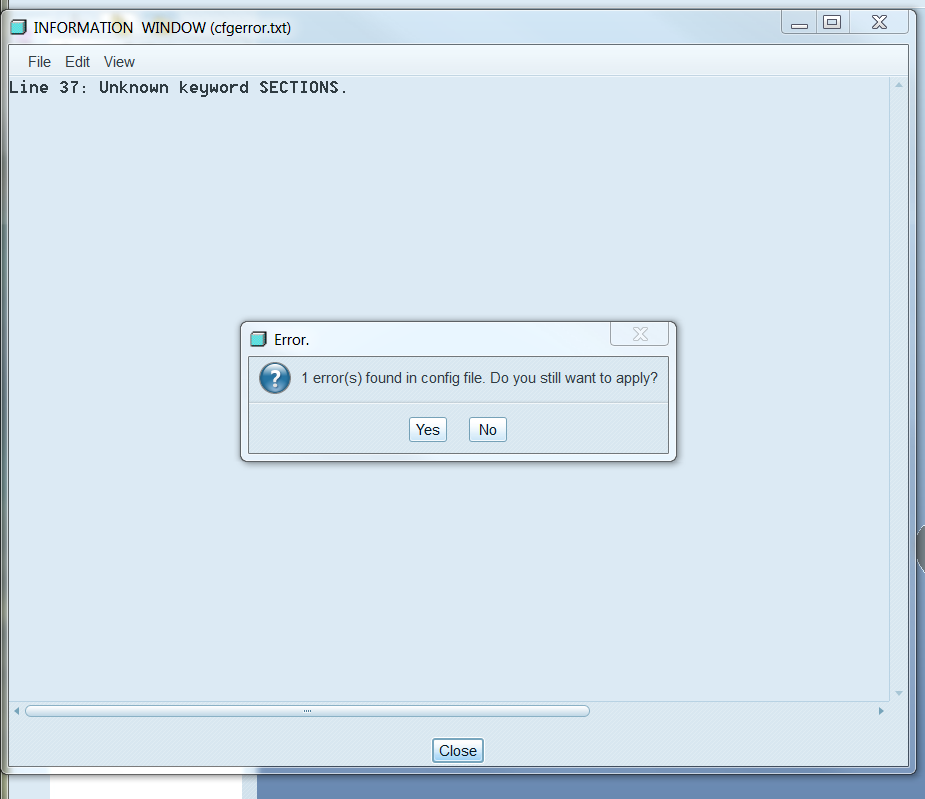

Any ideas what this is about? this pops when opening any prt assembly or drawing in Creo/pro5.0. The error started occuring after a Creo 2 installation.

Hi Nick,
You have to share your config.pro file for us to have a look, your problem will be in your config.pro file.
Hugo
July 27, 2012
Hello again,
I suggest that you create a copy off your config.pro file and just put the 5 variables each time untill your pro-e fails to see what precisely variable are doing that error. I would test that but i am not using that version anymore
Hugo
July 27, 2012
The issue was contained in the tree.cfg file line 37 "SECTIONS ON"
July 27, 2012
you are missing a "_" on your file
it sould be "SECTIONS_ON"
