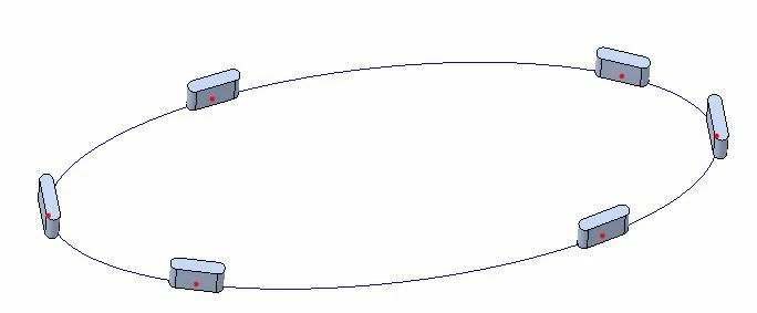

A picture may help, but have you tried a point pattern on a curve? You can control the point spacings with relations or with sketch constraints depending on how you want to set it up. The picture below isn't a chain but it shows that you can pattern on points that are non-equally spaced while following the direction of the curve.

The problem is that the length of the link is linear (straight line), and that distance can't be done simply using points on a curve spaced on the length of the distance between points on the curve itself.  On a small sprocket radius, the length between points will be a good percentage larger than on a large sprocket radius where the curve is almost a straight line, and then there is the fact that in most runs there IS a straight section.  On a drivetrain that has numerous sprockets it becomes extremely complex.  Therein lies the problem.
