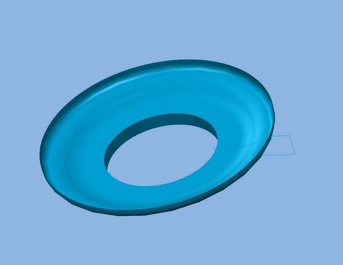

Hi everyone,
In WF4, I can change color on either side or both side of a surface by flip the red arrow or choose both (using quilts feature).
But in Creo 1.0, I can not choose side, It only do both sides.
Please help.
Best answer by BrianMartin
Hi Dovan...
I tried everything I could think of to get this back to the way it used to work. I was not able to color the surfaces the way I could in previous releases. I appears it's been changed. I looked for config.pro options and found nothing relevant.
I will say I like it better this way (the new way) because I always thought having to pick which side of the surface to color was annoying. But then I always wanted the entire surface the same color. If you've made some use out of the difference between the two sides, then this is now a problem for you.
Perhaps they'll add a switch setting to toggle the old/new styles. Or, perhaps this is a switch but it's hidden? This might be worth a call to PTC customer support.
Thanks!
-Brian

DOVANLE1-VisitorAuthor
June 26, 2012
Hello Brian,
Thank you very much for the info. I did try evrything I could think of but wasn't able either. I'm glad we're on the same page, this way I know for sure I did not miss anything.
It is not a big problem for me. However this is one of the way for me easier to verify my work.
DoVan
