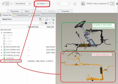

I have a part that when I add it or apply Edit Definition in Default position it is out from where it should be. Then I need to Edit Definition it, move it to where I need and fix it. Someone knows if it is possible to change the Default position?
I have Creo Parametric
Thanks!!

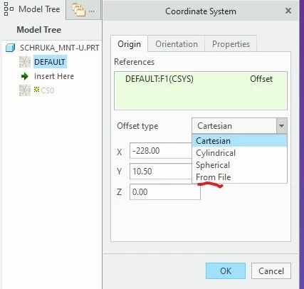

kdirth
October 21, 2019
Transform Measure: Select last button, Select blue info icon and save the file.
Coordinate System: Create new coordinate system from the default and select From File and select file previously created.
Edit References: Select all features that reference the default coordinate system and select the Edit References button from the pop up.  For every instance of Default (CSYS) select the new coordinate system as the replacement.
