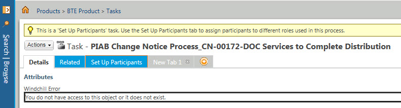

This is a bit baffling.
The test account in the Documentation Services group that's in the Change Administrator role (in the Team and in the Workflow) is sent a task.
They can see the task as normal in My Tasks, but when they open the task, the Details page displays
Windchill Error
You do not have access to this object or it does not exist.
Thing is, if I reassign that task to another test account (wctest1) not in the Documentation Services group (who is in the Change Administrator role) they CAN see it. The Doc Service account cannot reassign the task, so I need to do that as Admin.

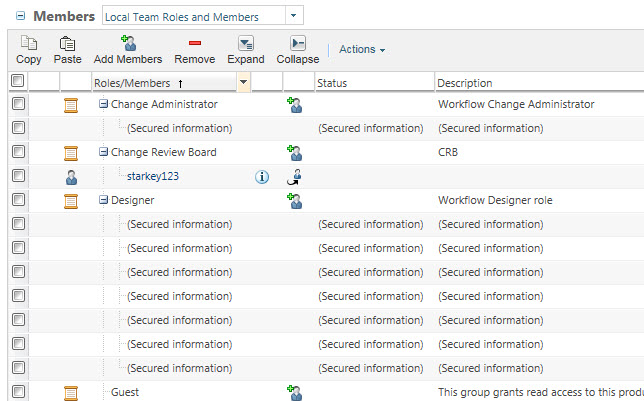

The only other clue is that the same test account (Documentation Services group in Change Administrator role) gets a (Secured information) when looking at the Assignee on the task.
The user in the Change Administrator role cannot see the Change Process in the Routing/Process History?

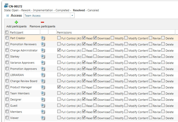

From the change object (try each - change request, change notice, change task), select Manage Security, then search for the specific user (green "+" icon) and look at their permissions.  They may not have access at the current state.
Their workflow task remains and they can see it regardless of the access to the parent object (PBO) of the workflow process.
A useful and quick troubleshooting technique is to temporarily add them to the Manager Role of the context team where the data / change object is and see if that fixes it.  If so, it's definitely a permissions issue.(ACLs).

Change Administrator has Full Control (at all States) for CR, CN and CA... as I have been trying everything I can think of.

Is that user actually in the Change Administrator Role for this context?
Use the Green Plus, search for the user and show specifically for that user.
