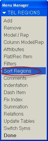

I have added some tool numbers into a program out of order. In the manufacturing tool setuplist they are in orderbut when usinga table and repeat region to grab list in detailing, Prowill not listtools in number order. The toolsare listed in order as they were put into the tool setup. How would change the sorting on this?

Dale,
Try to sort the region "TOOL" using the following sequence shown below:
