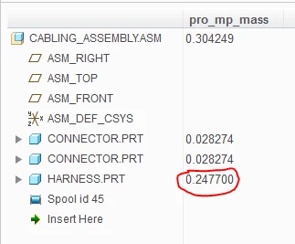

Hi, everyone. I'm having an issue with getting a proper mass of my harness parts. Rather, the mass is right but the unit is wrong. I used the Creo mmns template file for my harnesses and now they report mass in tonnes. I want to change the mass units reported with the PRO_MP_MASS parameter, but since I cannot open a harness part by itself, I find no way of getting into the model properties to be able to change it. Does anyone have a workaround for this?

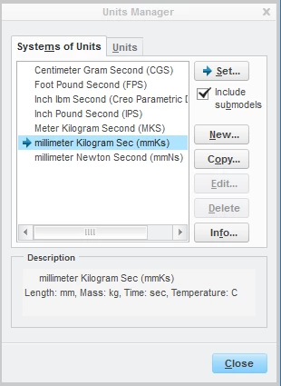

Best answer by MartinHanak
I hope I found a solution ... see attached CS155622.pdf.
1.] activate Cabling assembly
2.] click File > Prepare > Model Properties, then change in Units row
3.] set a System of Units and tick the "Include Submodels" box to propagate to harness
4.] regenerate assembly

Hi, Martin.
I could, but I don't see how that would help. Anyone can recreate the issue this way:
  1. Start an assembly.
  2. Launch the Cabling module.
  3. Create a new harness part.
Having done the above steps, how is it possible for me to change the units in the harness part? I can change the length units through the Setup command, but this doesn't allow me to change the mass units. I can create a new harness part with different units by using a different template part, but is it possible for me to change the mass units for the existing one?
