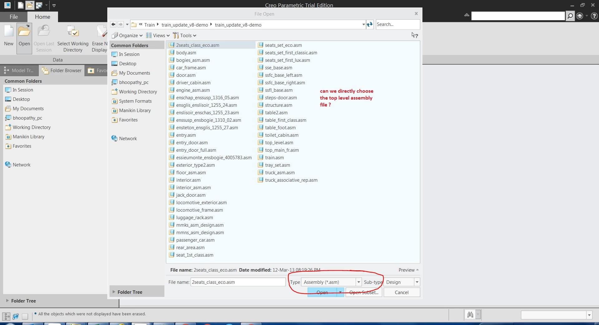

Hello PTC Community,
Kindly facilitate to Choose top level assembly file directly for ease of use?
thanks
bhoopathy

Hi Boopathy,
I do not think it is possible.

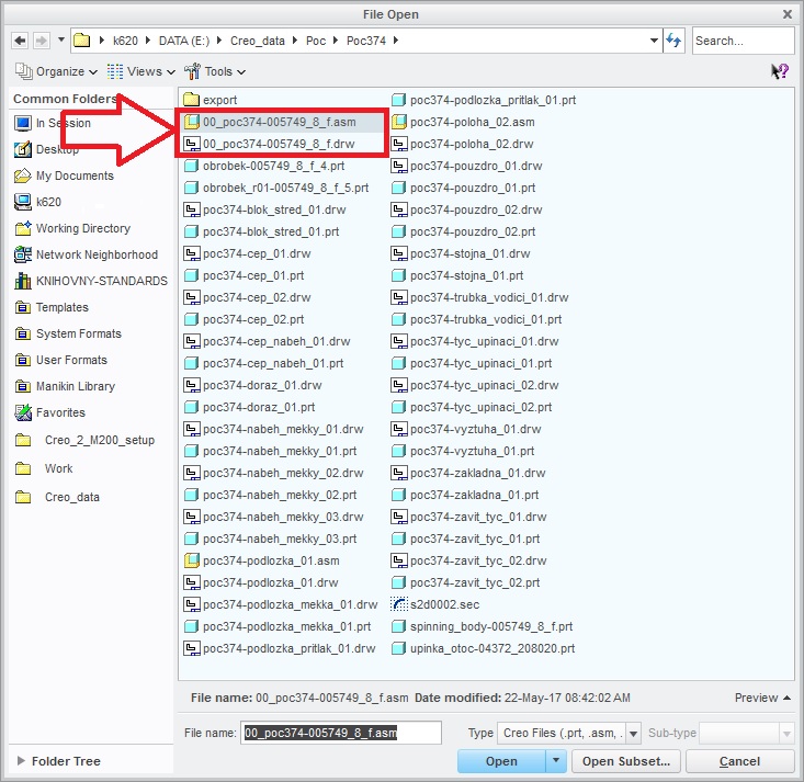

May 26, 2017
I identify the top level assembly like this: Filename-TLA.asm.
And weldments, which are parts in the physical world, but assemblies in Creo like this: Filename-WLD.asm.
2-Explorer
May 26, 2017
Hello Bhoopathy K
the best way "How to select top level assembly" is following:
Top level assembly is named like: 00_ ...
This will guarantee, that top level assembly will be shown as one of first row.
Our PTC provider AVengineering use the same method...
Regards
Milan Bonka
May 26, 2017
This is not possible out-of-the-box.  Just how would you have the system determine that a file is a top-level assembly?
By the way, if you don't have Windchill and access to where-used function, then this might be an alternative:
Where used?
