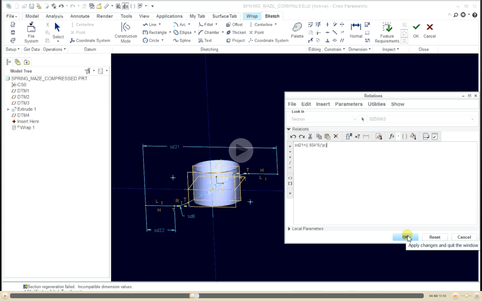

- Using the Coordinate system in the Wrap Section. You might even opt for sketching in the section starting at the bottom of the cylinder.
- Using Pi*D*No. of Turns to manage the overall swap.

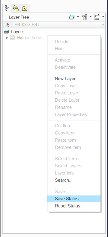

- Remembering to save the hidden layers.
- Tweaking the Wrap Section to maximize accuracy.
