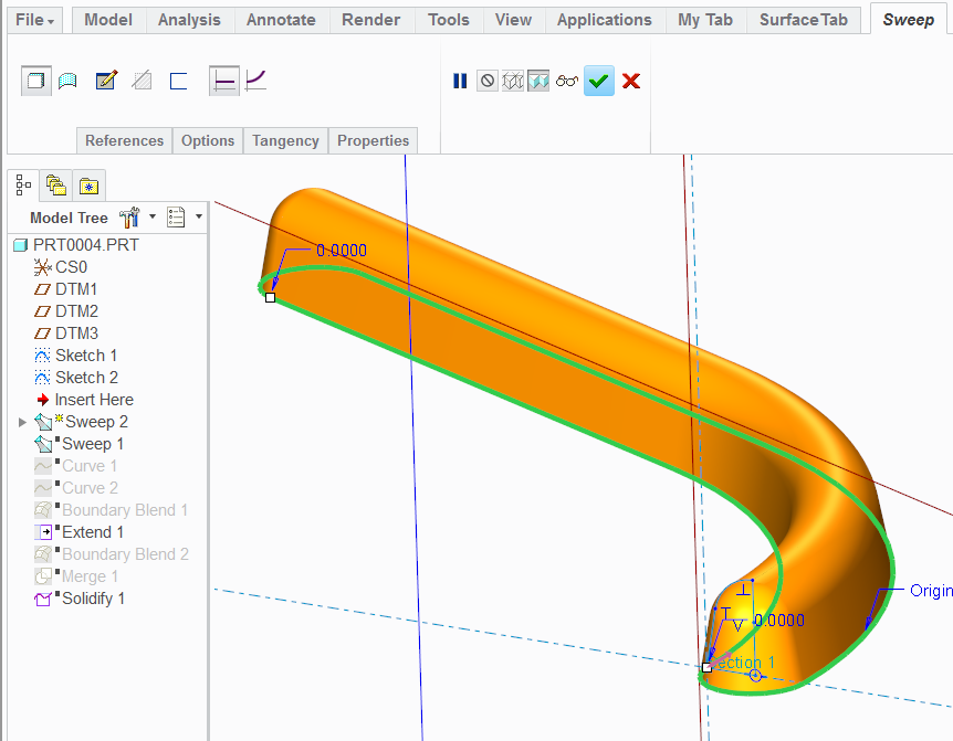

Recently, in my work I have to do a lot of sweeps, like the one bellow:
Now, to close the ends I have to do a revolve:
This doesn´t seem much work, but, to do the revolve it takes about 23 clicks (Revolve, Select Plane for skecth, add references, define axis, project, trim...) for each end. Total of 46 clicks for closing both sides.

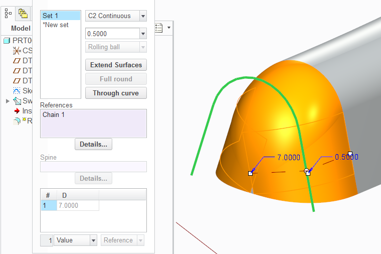

If you don't mind a small pip, a round does pretty well.
...and it can be C2 continuous.

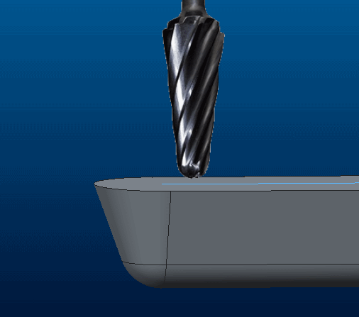

Since this is a channel to be milled, I have to keep the profile (angle and radius):
Nice pic, Huh??

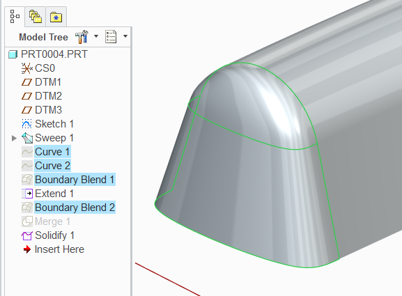

I got to this within a few hundred... maybe a 1,000 clicks
Only few hundred more clicks might have achieved round'r ends.
I'm proud of it though... fully bound with curvature contraints!
Of course, you could sweep the 1/2 profile around the periphery .
