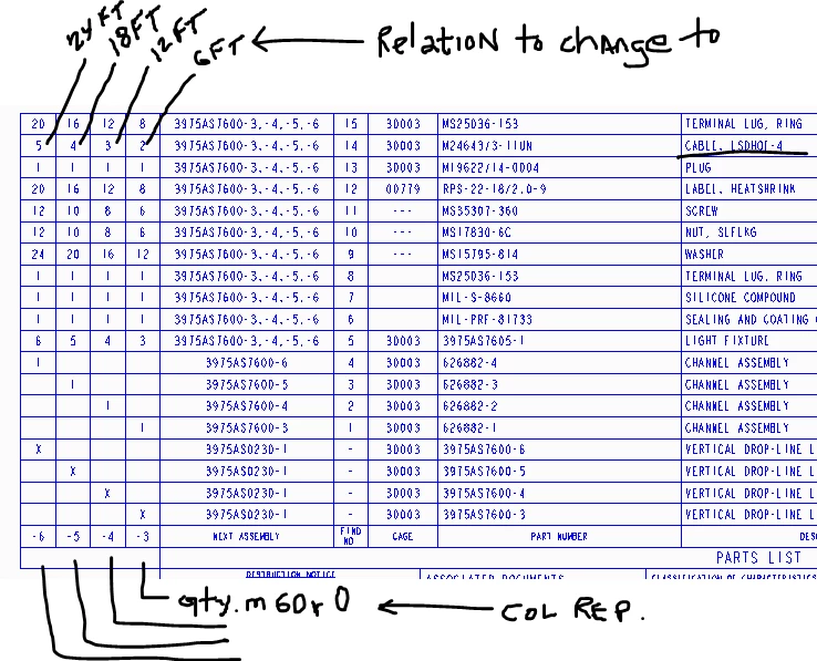

Can I write a relation for above col rep'd bom?

do you want to change values for CABLE item, only ?
Which repeat region parameters are displayed on first four columns ?
wfalco16-PearlAuthor
October 17, 2017
Hi Martin,
Yes - just the cable for now.
In the columns the following were generated by rpt region col rep command:
-3 qty.m60r0
-4 qty.m64r0
-5 qty.m68r0
-6 qty.m2r0
Wayne
October 17, 2017
I have never seen something like qty.m60r0. I know for example &asm.mbr.name or &rpt.rel.myparam included in repeat region cell.
