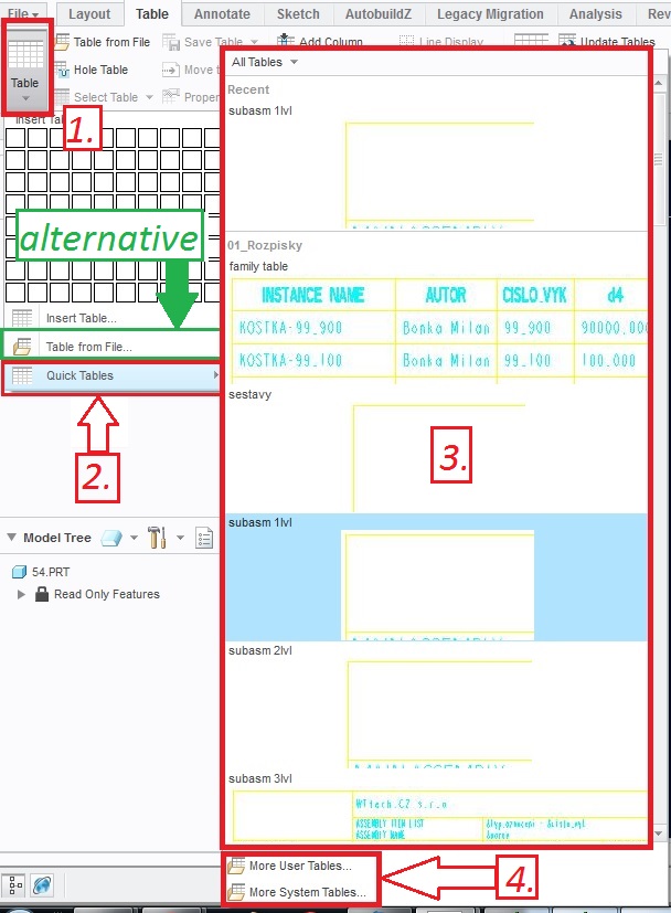

if you need informations from all tables A,B,C,D try folowing idea  ... PUT ALL DESIRED INFORMATIONS IN ONE COMPLEX TABLE INSIDE DRAWING SPACE.

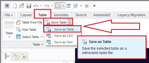

1) Create new more complex table and put all desired informations in.
2) Save your table as table file (*.tbl) see picture below.
3) Set following configuration options:
pro_table_dir --- for example: C:\Aplic\Creo_2_M050_setup\table  --- Specifies the directory to be used when tables are retrieved or saved. Use the full path name to avoid problems.
4) Use your tables in drawing space like following. It needs more investigation from your side to understand how it works...
Personally likes Quick tables function.

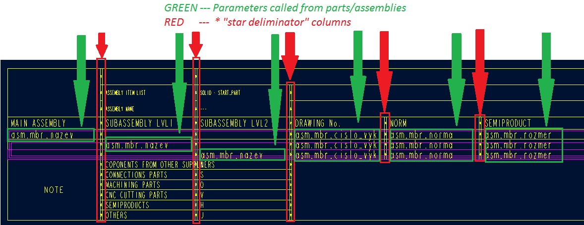

Tips and tricks:
A) If you are not sure if "this parameter" should be included in "this table", it´s is better to include it. If you will change your opinion later, it´s much eaesier select unwanted column and press delete, than creating of new column eachtime many times.
B) Use some "delimiter" between columns, if you expect that your tables will be export to excel. See picture below.
Afterwards save your table as text file. This *.txt  file import to excel and use special mark (in our case THE STAR * ) to divide columns.
Hope it can helps...

February 20, 2016
If you want to keep them aligned, there is no function for that. If you want to align them, then you can position the tables to exact coordinates by picking a table cell, then select the pull-down for Select Table and pick on Select table, then moving the cursor over the corner to be aligned and right clicking to get the Move Special pop-up. This will allows entering coordinates of the destination for the corner of the table.
