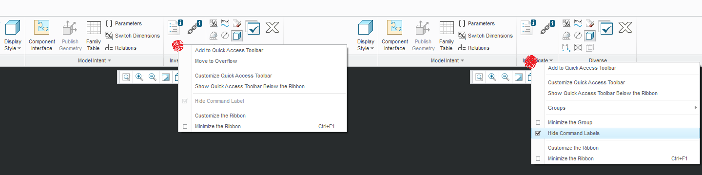

I filed a case with PTC Technical Support regarding this, but it's not consistently repeatable. I'm interested to hear if anyone else has experienced this.
When switching between applications in Creo Parametric - mostly between Cabling to Standard Assembly mode, but sometimes when switching between ISDX and Standard Part mode - the Command Labels hide, so all you see are the icons. Then I have to right click on each Command Group to Unhide Command Labels (or restart Creo if I'm really lazy).
It's more of an annoyance than anything else. We're on Creo 3.0 M040, and I first noticed this behavior in M030.

I also get this frequently. It is annoying, but I have found that if you right-click on the group bar beneath the icons, the greyed-out "Hide command labels" reappear as it should. So you can restore the labels per group.

Yes, it's easy to rectify, but annoying none the less. I also notice it happens when deactivating components in assembly mode and sometimes switching between a subassembly and returning to its parent's window. I'm on M070 and still experiencing it.
