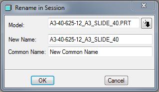

But, I take it when you have Pro/E open and you open the part and go File -> Rename you do not get the option to change the common name, like this:

you can also change Common Name using the following procedure.
1.] Create the temporary relation in the part (which you want to rename)
PTC_COMMON_NAME="new common name"
2.] Regenerate part
3.] Remove temporary relation (created in 1.])
4.] Rename part (you will see new common name in Rename dialog)
